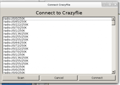

I noticed the following behavior which I expect to be related to the crazy radio on an usb3 port. The connect dialog lists hundreds of crazyflies which obviously aren't there. Crazyradio version 0.51
Any ideas on how to solve this?

I 've only got the crazyflie or about a week or so. I had to update the crazyradio to 0.51 to get the radio recognized on a usb3 port in the first place. From the moment the radio was 'working' it had this output in the connect dialog.marcus wrote:Is this something that suddenly started happening or has it always been like this?
Since version 0.50 the scanning is done in the Crazyradio firmware in order to make it faster (the command is sent here). What you could do is to print the touple created at this row to check that it's actually the radio that is reporting all of these devices and not a bug in the client.
/Marcus
Below the output of the cfclient after pressing the connect button (did not press 'scan' in the connect dialog still that function was called 3 times)
output: Info: Using config path: /home/andre/workspace/crazyflie/crazyflie-pc-client/lib/../conf
Info: sys.path= ['/home/andre/workspace/crazyflie/crazyflie-pc-client/lib', '/home/andre/workspace/crazyflie/crazyflie-pc-client/lib/../conf', '/home/andre/workspace/crazyflie/crazyflie-pc-client/bin', '/usr/lib/python27.zip', '/usr/lib/python2.7', '/usr/lib/python2.7/plat-linux2', '/usr/lib/python2.7/lib-tk', '/usr/lib/python2.7/lib-old', '/usr/lib/python2.7/lib-dynload', '/usr/lib/python2.7/site-packages', '/usr/lib/python2.7/site-packages/PIL', '/usr/lib/python2.7/site-packages/gtk-2.0', '/usr/lib/python2.7/site-packages/setuptools-0.6c11.egg-info']
INFO:cfclient.cfclient:Disabling STL printouts
INFO:cfclient.utils.config:Dist config read from /home/andre/workspace/crazyflie/crazyflie-pc-client/lib/cfclient/configs/config.json
INFO:cfclient.utils.config:Config file read from [/home/andre/workspace/crazyflie/crazyflie-pc-client/lib/../conf/config.json]
INFO:cfclient.utils.config_manager:Parsing [PS3_Mode_1.json]
INFO:cfclient.utils.config_manager:Parsing [Generic_OS_X.json]
INFO:cfclient.utils.config_manager:Parsing [PS3_Mode_2.json]
INFO:cfclient.utils.config_manager:Parsing [xbox360_mode1.json]
INFO:cfclient.utils.config_manager:Parsing [xbox360_mode1_linux.json]
INFO:cfclient.utils.logconfigreader:Parsing [stabilizer.json]
INFO:cfclient.ui.tabs.FlightTab:Changed flightmode to Normal
INFO:cflib.crtp.radiodriver:v0.51 dongle with serial N/A found
tuple len 64
(64, 249, 120, 165, 0, 136, 255, 255, 192, 244, 120, 165, 0, 136, 255, 255, 208, 244, 120, 165, 0, 136, 255, 255, 208, 244, 120, 165, 0, 136, 255, 255, 0, 179, 52, 119, 0, 136, 255, 255, 224, 139, 2, 79, 1, 136, 255, 255, 176, 187, 164, 31, 0, 136, 255, 255, 208, 187, 164, 31, 0, 136, 255, 255)
tuple len 64
(128, 204, 147, 56, 1, 136, 255, 255, 131, 204, 4, 0, 208, 24, 1, 0, 125, 37, 156, 0, 1, 0, 0, 0, 0, 1, 16, 0, 0, 0, 173, 222, 0, 2, 32, 0, 0, 0, 173, 222, 0, 0, 0, 0, 0, 0, 0, 0, 0, 1, 16, 0, 0, 0, 173, 222, 0, 2, 32, 0, 0, 0, 173, 222)
tuple len 64
(64, 249, 120, 165, 0, 136, 255, 255, 0, 249, 120, 165, 0, 136, 255, 255, 3, 0, 0, 0, 0, 0, 0, 0, 0, 0, 0, 0, 0, 0, 0, 0, 152, 154, 111, 61, 1, 136, 255, 255, 24, 68, 14, 66, 1, 136, 255, 255, 0, 0, 0, 0, 0, 0, 0, 0, 0, 0, 0, 0, 0, 0, 0, 0)No, latest stable.atomicdog wrote:Do you have special firmware on the crazyflie?

Thanks for the info. It's the dongle that is returning very strange values....
The three tuples for 250K/1M/2M and they contain the channels the firmware has found a Crazyflie on. Do you get the same result (i.e lots of channels) when your Crazyflie is off as well?

yes, I get the same result if the crazyflie is powered off.
Maybe good to mention that I have a different PC (Linux Mint 13) on which I don't get this behavior (i.e. works as expected). That is on usb2, hence my suspicion that it is related to usb3.
