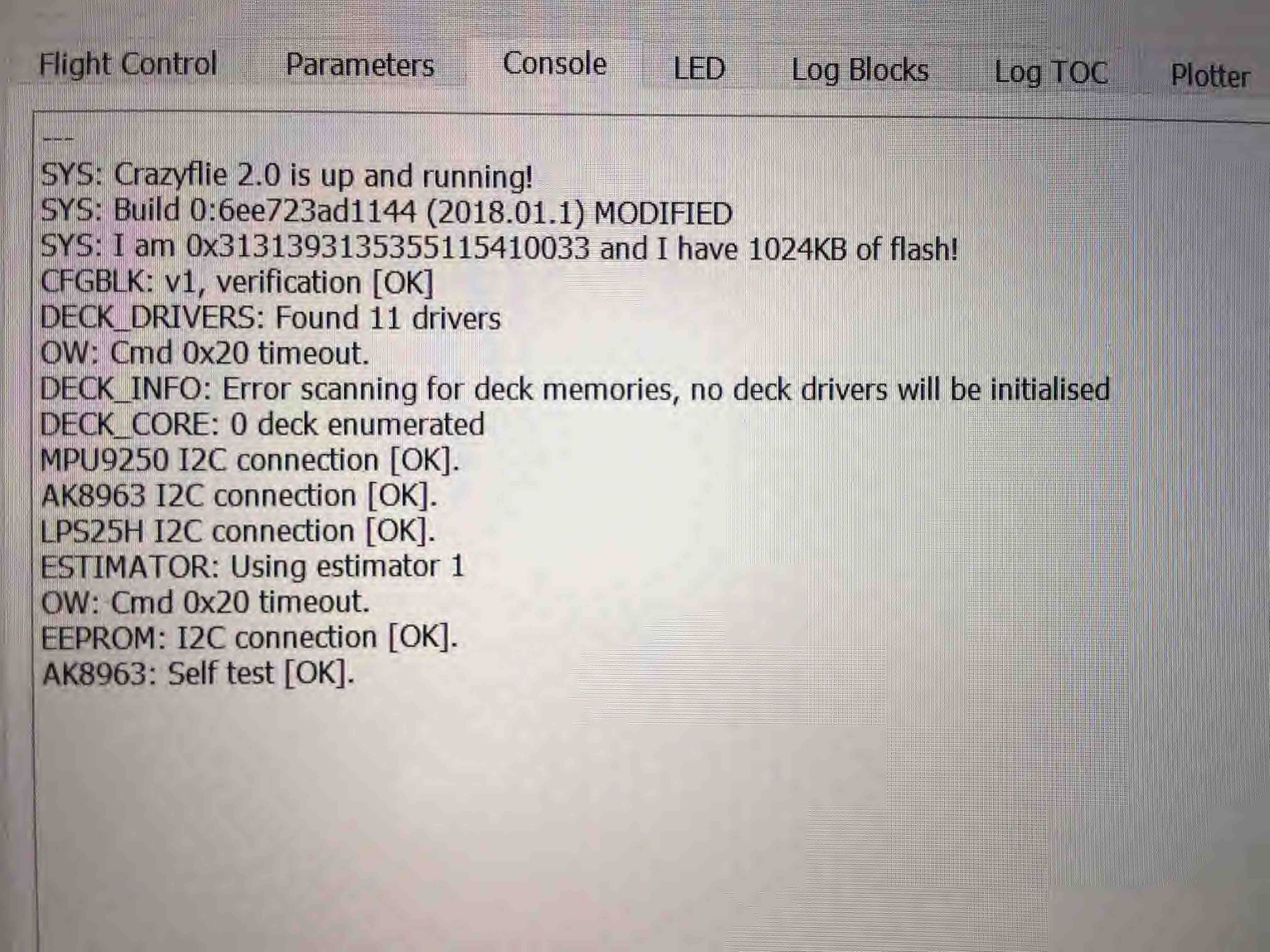

I did some tests with my crazyflie 2.0 loaded with 10g extra weight. In the third run the CF flies into my safety net and crashes about 30cm down into the floor. After this crash the selftest of the CF won't work anymore and the M1 led blinks fast 5 times. I run it through the usb into the cfclient and got the messages in the picture. Apparently the there is something wrong with the "deck memories". What should I do? Is it possible to fix or do i need to replace something?

Most likely something happened with the deck connector on either the CF2 or on the deck. The 1-wire memory is located on the deck so especially check the OW signal. See the pinout for signal location.

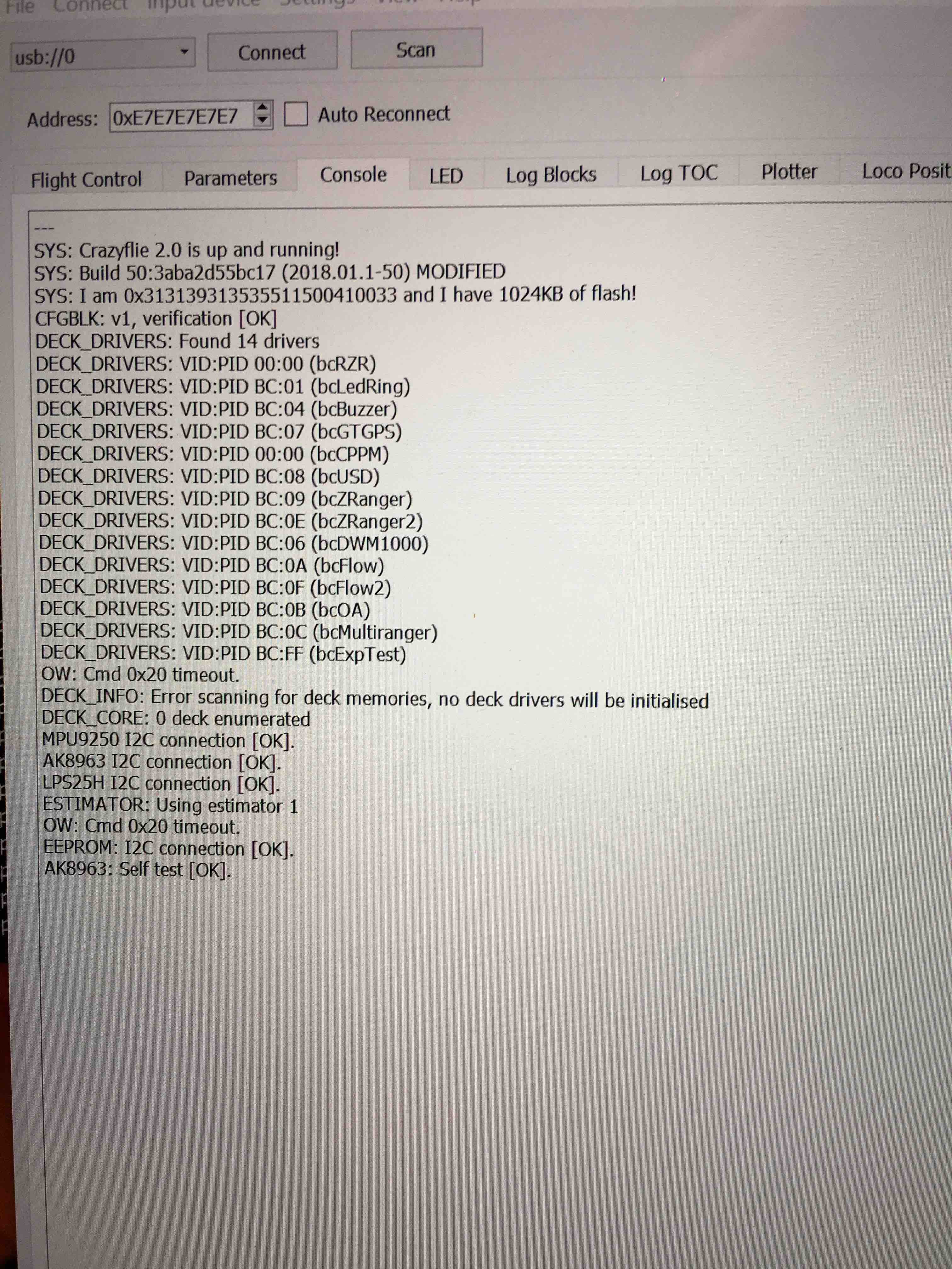

Do you know how to compile and flash the firmware? If so could you build a debug build "make DEBUG=1 CLOAD=1" and flash it and post the cfclient console output here after connecting to it.

This is the result of running with the new firmware. If it is the cfrazyflie that is broken is it possible to replace only like the motherbord of it or do i need to buy an entire new crazyflie? Since the motors seem to work fine.
