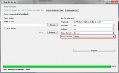

It might be Wifi that is interfering. You could try the following: using the bootloader, switch your Crazyflie to using 1M instead of 250K bandwidth:

Still the same error should I try with 2M?

Hm, no, then it's probably something different I guess... Maybe someone else has a better idea, sorry.

Changing the channel is more important (then bandwidth) when trying to avoid interference from WiFi.
You may need to try a few different channels.
