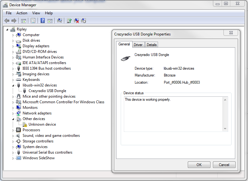

I am having an issue getting my CR to work in Windows (Win7 x64). I installed the driver for it (and it shows up fine in device manager) but CFClient doesn't attempt to scan - it immediately returns just the debug device. I grabbed the latest CFClient code and ran it directly and it says:

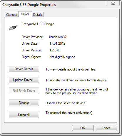

Just to be on the safe side, does you driver setup look like this?

My drivers look the same:
I set up the x86 VM, passed through the CR and 360 controller, tried with the same Windows version of CFClient...and it worked fine
So at this point it must be something with my x64 installs. I haven't had issues with it in the past, but maybe it is the driver signing. I set the options to disable but they wont take effect until next boot...I will try that tomorrow
Thanks again
