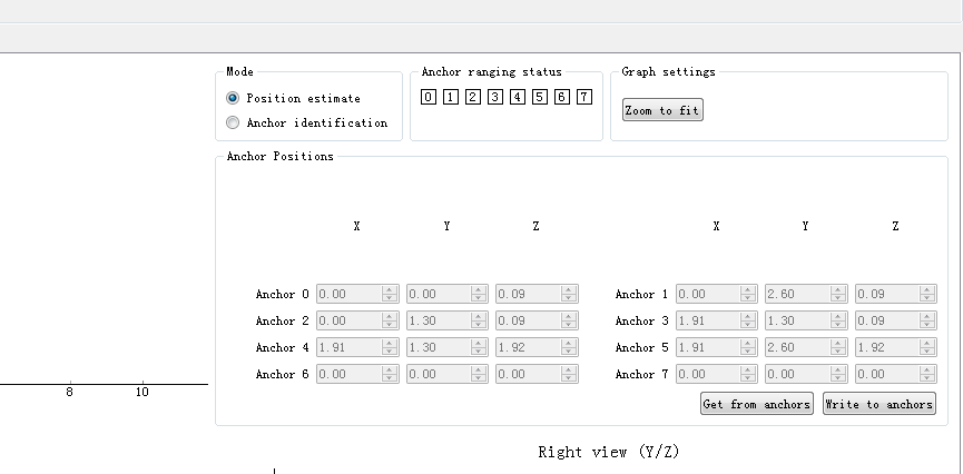

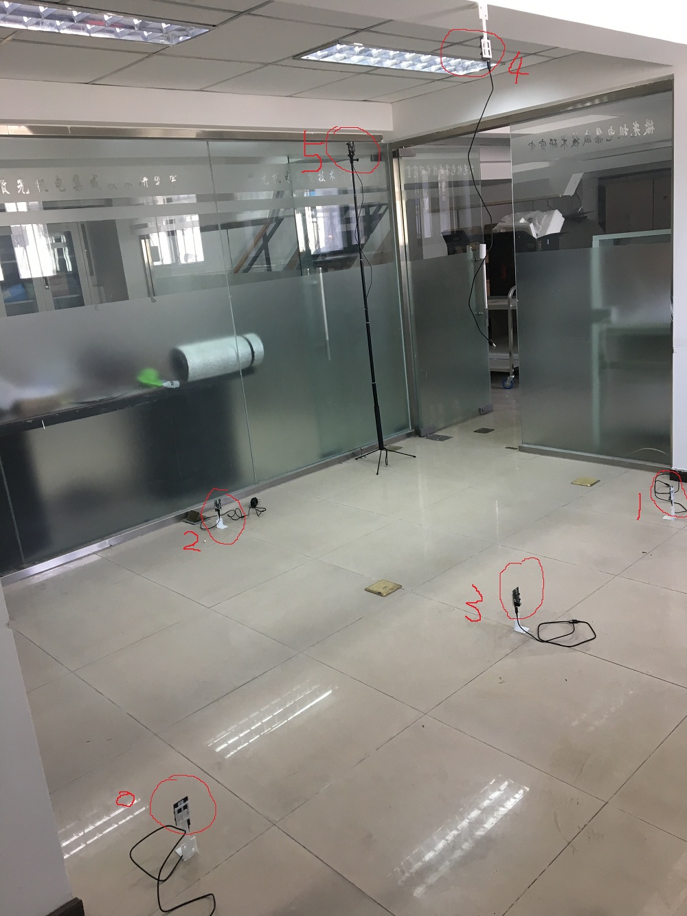

Thanks again for your reply.I have 6 anchors. I use the client in windows.There is no mode option(Auto/TWR/WDoA)(attached picture '2.jpg'). I can see a stable position estimate in the LPS tab in client(It doesn't look like much error).But I can't stabilize crazyflie with the gamepad in position hold (according to the 'Getting started with Position hold'), the crazyflie will float away just like there is no LPS. I also ran the program using the commands from 'crazyflie-lib-python\cflib\positioning\motion_commander' or 'crazyflie-lib-python\cflib\crazyflie\commander'.The crazyflie also can't hover and floats away.I don't know what caused it.The coordinates of these six anchors are: 0(0,0,0.09),1(0,2.6,0.09),2(0,1.3,0.09),3(1.91,1.3,0.09),4(0,1.3,1.92),5(1.91,2.6,1.92)(Unit/m).The attached pictures('869848721.jpg') show the place situation of LPS.

Thanks for the details. Your setup looks correct for TWR positioning.
Your client does not seems to be at the latest version, this is why you do not see TWR/TDoA. This is not a problem if your want to fly only one CF in TWR.

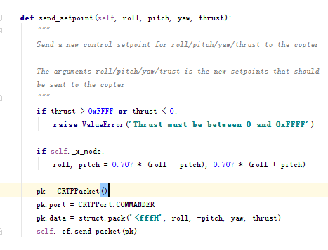

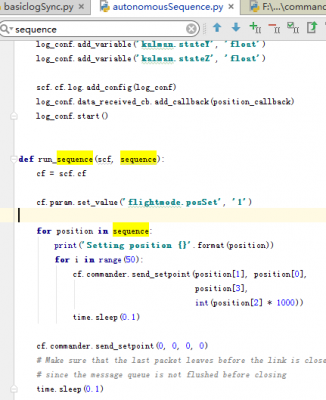

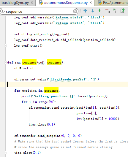

Thank you for your reply.I tested the ‘autonomousSequence.py’ script with LPS only. Though, I don't kown whether there is drift, it looks like the crazyflie didn't fly according to the setpoint I gave.I have read 'autonomousSequence.py'.I found that the function 'cf.commander.send_setpoint(position[1], position[0], position[3],int(position[2] * 1000))' was called in 'run_sequence'.I also read the function 'send_setpoint'. I found that the parameter used by this function is 'roll,pitch,trust,yaw'(def send_setpoint(self, roll, pitch, yaw, thrust):).So the sequence pointsthat we set up at the beginning in ‘autonomousSequence.py’ are ‘roll, pitch, trust, yaw’ instead of ‘x, y, z, yaw’.It seems that the LPS system position control is meaningless.I want to know what's wrong with my understanding?
Thank you!!
Posts: 2538
Re: The position data of crazyflie
Post by arnaud »
This script is using a little bit of legacy code: originally Crazyflie 2.0 did not support any kind of position control and back then we used the roll/pitch/yaw/thrust setpoint packet for everything the meaning of the packet fields. For example we had a parameter to start interpreting thrust as height-change to implement height-hold. This script is setting to 1 the parameter "flightMode.posSet" which makes the Crazyflie interpret roll/pitch/yaw/thrust as y/x/yaw/Z(in mm).

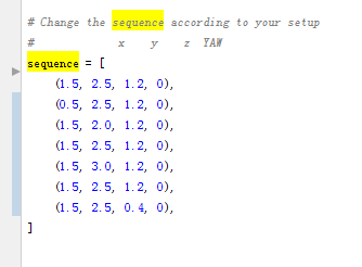

Thank for your reply.The crazyflie flied randomly and often run into walls (when ran the 'autonomousSequence.py').One of the rotors was damaged. So I'm set only one point (0,0.5,0.5,0).I hope to find the law of crazyflie flight in flightMode.posSet mode,but I didn't. I think that when I set the point (0,0.5,0.5,0), the crazyflie will fly into the space (0,0.5,0.5) (x/y/z,absolute position), but it didn't, but it was flying in a direction that was not expected and then fell.When I set the point to (0,0,1,0), the crazyflie will fly sideways and fall (should it not fly vertically?).
Another question is that every command will be executed 50 times to maintain the 5s?(
for i in range(5):
                                       position[3],
            time.sleep(0.1)
). I don't know the exact meaning of this command, and why does it have to be executed 50 times? For example, executing once command ' cf.commander.send_setpoint(position[1], position[0],position[3],int(position[2] * 1000)', the crazyflie should move ‘position[0]’(Unit /m) along the X-axis, ‘position[1]’ along the Y-axis and 'position[2]' along the z-axis, right?
Are the sequence of points we set at the beginning the absolute position in space? Under normal circumstances, the crazyflie will arrive at these points in turn, right?
Thank you!!

The setpoint needs to be sent often: the Crazyflie has a watchdog that will makes roll/pitch=0 after 0.5s and cut the motors after 1s if no setpoint is received. Sending setoint at 10Hz like in the loop you copy-pasted.
The positions in this script are absolute positions and the expected behavior is that the Crazyflie should hover at the set position.
