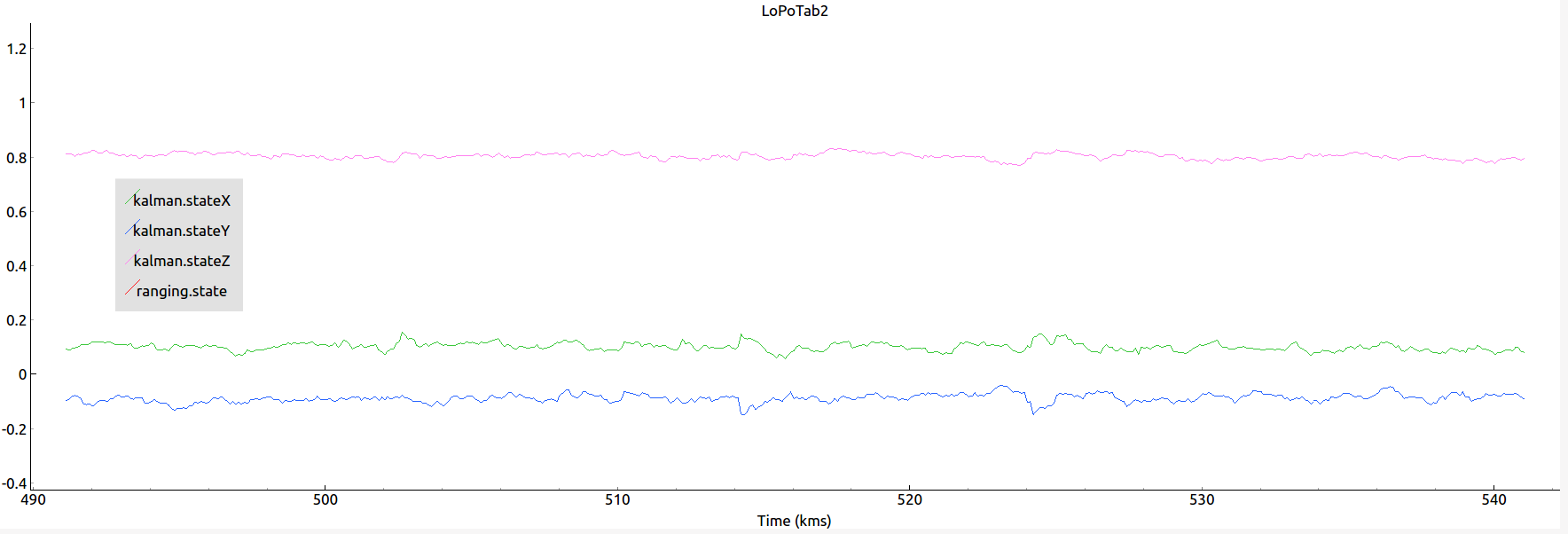

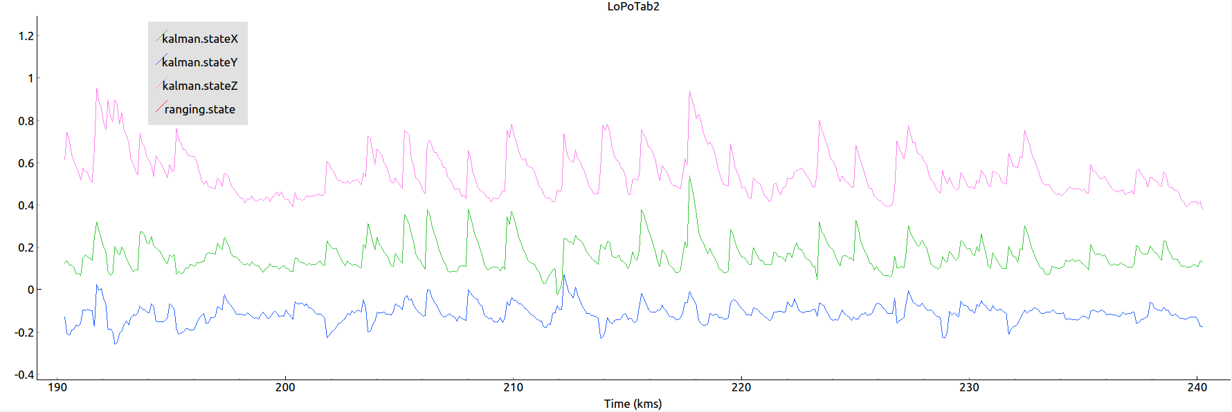

I'm attaching a cfclient capture of a static Crazyflie in the middle of our flying arena. For comparison I have included data using TWR and TDOA2.
Basically with TDOA2 we are getting continuous peaks in the measurements, which we assume are due to outliers.
The Crazyflie is placed well within the convex hull of the anchors as well (it is sitting in a chair in the middle of the flying arena).
I just want to confirm with other people if this is the current state of the TDOA estimations, and if the peaks are normal

I think it looks a bit noisy. I would expect something more like the TWR graph, not as spiky.

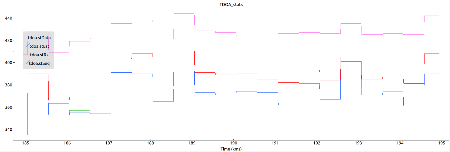

It might also be interesting to take a look at the TDoA statistics
tdoa.stRx = nr of received TDoA packets / s
tdoa.stSeq = nr of packets passing the sequence nr check / s
tdoa.stData = nr of packets passing data validity chekcs / s
tdoa.stEst = nr of packets passing outlier detection and actually passed on to the estimator / s
For a 8 anchor system stRx should be close to 500 packets/s without packet loss.
If all is good stEst should be closeish to stRx.

I'm including a graph with raw data from the TDOA and the statistics, as you suggested.

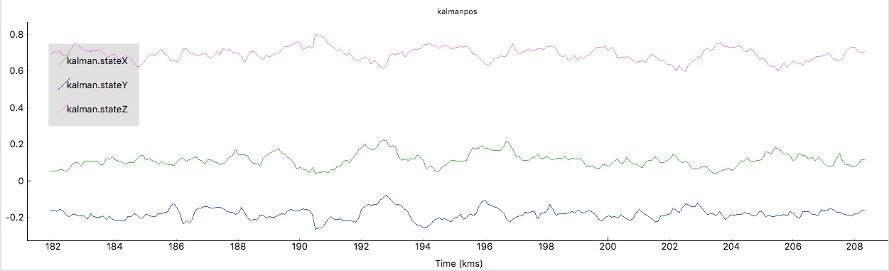

I made some iterations on different node position configuration, and finally found one that eliminated the peaks on the raw measurements, as seen in the figure attached.
However, this doesn't seem to improve the large variance I get in the position output from the Kalman filter
