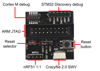

By the way, I am not a professional in this field, so I need to confirm that what I understood is correct.
Here is what I understood from your reply so far.
1.
I need to buy the debug adapter (figure).
Is only this one enough to resolve this issue?
What do you mean the debug adapter and SWD debug adapter?

- Posts: 2538
Re: Crazyflie not turning on
If you do not have the debug adapter, the DFU method should be enough.
After flashing the bootloader with DFU couldn't you get the bootloader to work? Both blue LED should blink when you press the power button for about 1.5s+
To answer your points:
1. The debug adapter board interface a SWD debugger (like ST-LinkV2 or JLink) to the Crazyflie debug port. If you do not already have one, the DFU method should work as well.
2. The debug addapter is what you need to flash th nRF using a debugger, but you would need to solder the small nRF debug adapter board to the nRF debug pads. Though I do not think you need to re-flash the nRF.
3. I would actually flash the release stock firmware package first as explained there: https://www.bitcraze.io/getting-started ... #latest-fw. When your Crazyflie is back up, you can flash https://github.com/bitcraze/crazyflie-firmware using the radio bootloader with "make cload".
