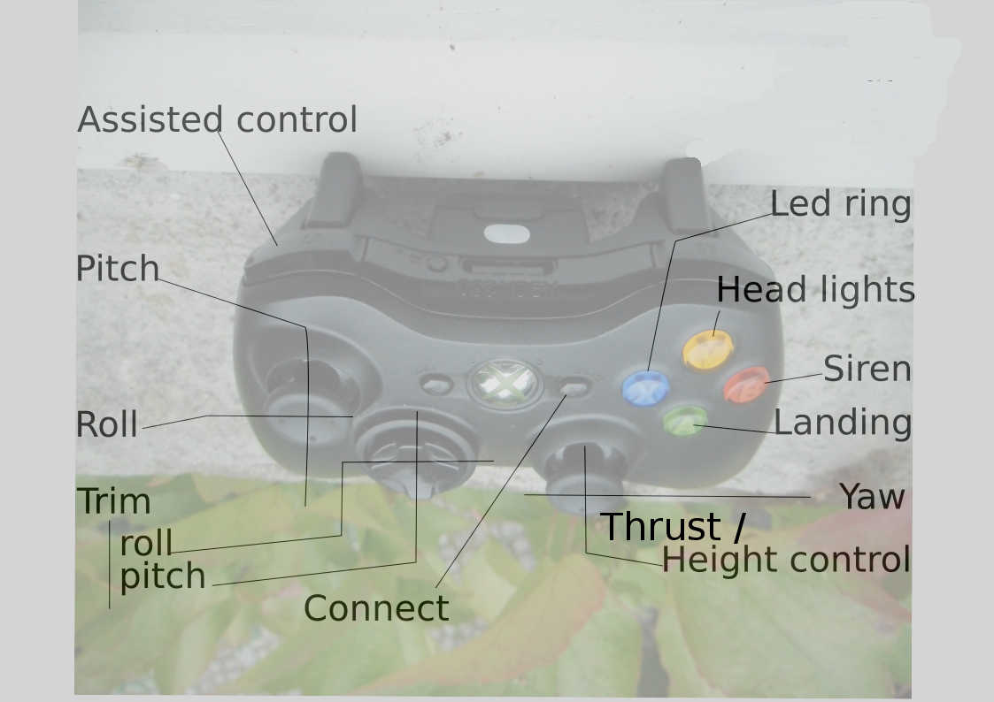

Hi everybody!
My json file for xbox360 wireless. Rather fine joypad... Power and rudder in right hand, control stick for roll and pitch for left hand, like in many modern real copters. The schema:
and the file:
"inputconfig": {
"inputdevice":
{"name": "Xbox 360 wireless left-handed, nexon", "updateperiod":10,
"axis": [
{"name":"Roll", "type":"Input.AXIS", "id":0, "scale":1.0, "key":"roll"},
{"name":"Pitch", "type":"Input.AXIS", "id":1, "scale":-1.0, "key":"pitch"},
{"name":"Yaw", "type":"Input.AXIS", "id":3, "scale":1.0, "key":"yaw"},
{"name":"Thrust", "type":"Input.AXIS", "id":4, "scale":-1.0, "key":"thrust"},
{"name":"Alt1(ring)+", "type":"Input.BUTTON", "id":2, "scale":1, "key":"alt1"},
{"name":"Alt2(HL)+", "type":"Input.BUTTON", "id":3, "scale":1, "key":"alt2"},
{"name":"Alt3(sound)+", "type":"Input.BUTTON", "id":1, "scale":1, "key":"alt3"},
{"name":"assistedControl", "type":"Input.BUTTON", "id":4, "scale":1, "key":"assistedControl"},
{"name":"Landing", "type":"Input.BUTTON", "id":0, "scale":1, "key":"landing"},
{"name":"Connection", "type":"Input.BUTTON", "id":7, "scale":1, "key":"connect"},
{"name":"Pitch Cal+", "type":"Input.BUTTON", "id":14, "scale":-1, "key":"pitchNeg"},
{"name":"Pitch Cal-", "type":"Input.BUTTON", "id":13, "scale":1, "key":"pitchPos"},
{"name":"Roll Cal +", "type":"Input.BUTTON", "id":12, "scale":1, "key":"rollPos"},
{"name":"Roll Cal -", "type":"Input.BUTTON", "id":11, "scale":-1, "key":"rollNeg"},
{"name":"killswitch", "type":"Input.BUTTON", "id":6, "scale":1, "key":"estop"}
