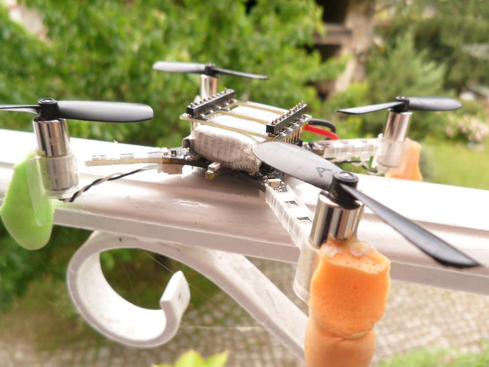

Thank you, I will look at the soft to know a little bit more. I feel it is an intuitive but useful way to understand the behaviour of propulsion system.
I tested without propellers an get the following:
STAB: Acc noise floor variance X:0.000501, Y:0.000489, Z:0.001441
STAB: Motor M1 variance X:2.440378, Y:2.169014, Z:0.958618
STAB: Motor M2 variance X:3.236053, Y:3.640677, Z:2.129615
STAB: Motor M3 variance X:0.292334, Y:0.203826, Z:0.933952
STAB: Motor M4 variance X:5.090236, Y:5.172710, Z:13.666160
STAB: Propeller test on M1 [FAIL]. low: 0.0, high: 2.0, measured: 4.60
STAB: Propeller test on M2 [FAIL]. low: 0.0, high: 2.0, measured: 6.87
STAB: Propeller test on M4 [FAIL]. low: 0.0, high: 2.0, measured: 10.26
My cf2 is equipped with soft landing gear: So, it's a soft ground, I think.
