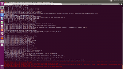

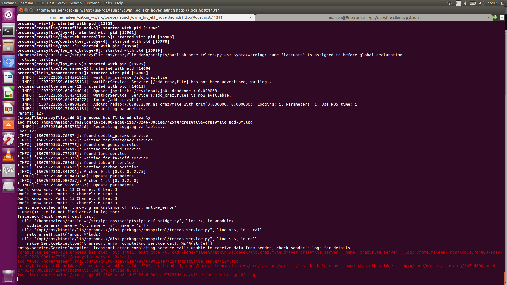

I followed the instructions for ROS at https://wiki.bitcraze.io/doc:lps:ros to try and hover autonomously. However the ROS node lps_ekf_bridge fails to execute properly.
reques
More specifically, when I try to launch
roslaunch bitcraze_lps_estimator dwm_loc_ekf_hover.launch uri:=radio://0/80/250K x:=2 y:=3.4 z:=2.5
a runtime error is thrown during the setting up of anchor positions. And confusingly, the runtime error differs from time to time and is thrown during different anchor setups. I have attached the screenshots for two attempts back-to-back without any changes to the system.

And the error message is
terminate called after throwing an instance of 'std::runtime_error'
  what():  Could not find acc.z in log toc!
  File "/home/janindu/phd_workspace/src/lps-ros/scripts/lps_ekf_bridge.py", line 77, in <module>
    update_params([name + 'x', name + 'y', name + 'z'])
  File "/opt/ros/kinetic/lib/python2.7/dist-packages/rospy/impl/tcpros_service.py", line 435, in __call__
    return self.call(*args, **kwds)
  File "/opt/ros/kinetic/lib/python2.7/dist-packages/rospy/impl/tcpros_service.py", line 525, in call
    raise ServiceException("transport error completing service call: %s"%(str(e)))
rospy.service.ServiceException: transport error completing service call: unable to receive data from sender, check sender's logs for details
Looking at this, it seems that acc.z is missing in the entries. Does it look like transmission corruption?
