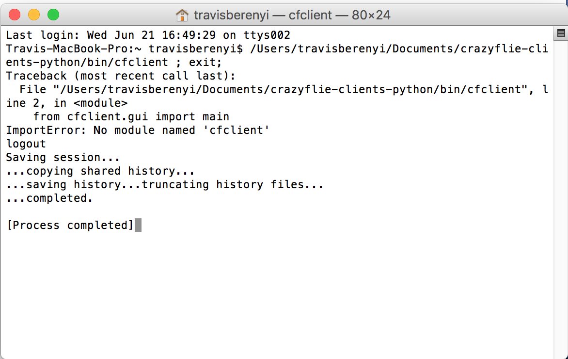

Can someone please help me out with this? I've installed macports, I'm using a Mac of obviously. I've been trying to figure this whole thing out for hours. I'm getting pretty much nowhere. This all started with trying to get into development for my crazyflie 2.0, it's just one dead end after another. Please help.

This message means that the client is not installed in the python package system. You should run the "pip3 install -e ." part of the documentation: https://github.com/bitcraze/crazyflie-c ... g-homebrew. When that succeeds, this error should be gone.
