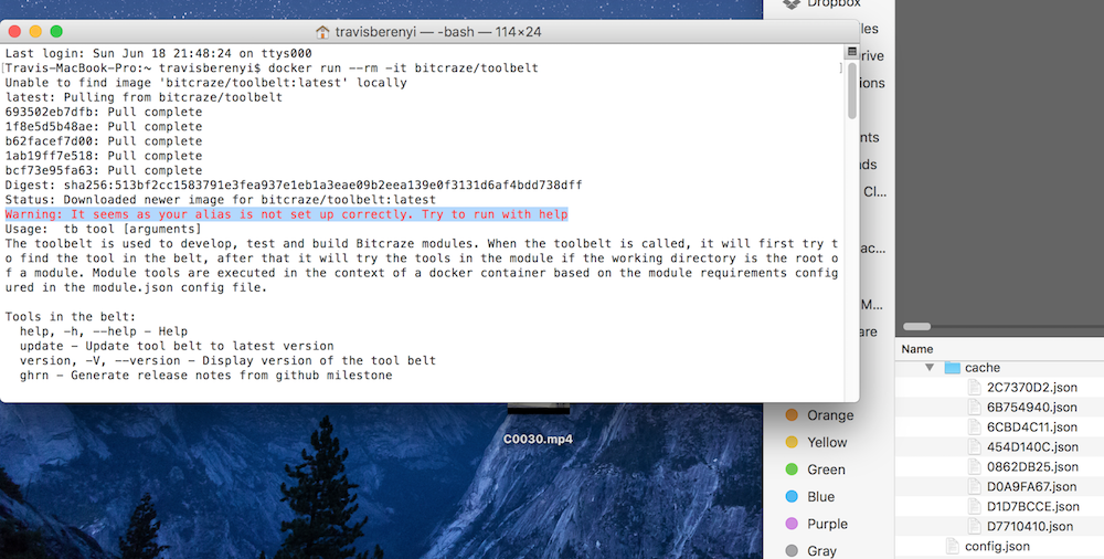

Im still trying to figure out how to create project folders for development. This is just a shot in the dark, but I downloaded "Docker". I hope that was one step that was okay to do, it's just that I don't wish to clutter my computer up with unneeded files. Someone let me know how to work this whole Docker thing please. I have included a screenshot depicting my problem. It's saying something about an "alias", I literally have no idea what that means. I also think I have to do something at the root of a specific folder? I'm dying to get some insight on this before I make a big mistake or anything. I'll be waiting for any assistance, thank you.

I'm also on Mac and I created the docker flavour of the development environment to solve the problems you are facing. I wanted to minimise the number of applications/languages/frameworks to install on the system while staying in the Mac world of tools. I'm using the toolbelt to build the firmware but has settled for running the python library/client natively (installing the required dependencies using pip3).
Looks like you have installed docker and run the toolbelt, that's a good start. A bit further down in output from the toolbelt you should find the following lines
Installation on linux, OSX and Windows:
Add "alias tb='docker run --rm -it -e "HOST_CW_DIR=${PWD}" -e "CALLING_HOST_NAME=$(hostname)" -e "CALLING_UID"=$UID -e "CALLING_OS"=$(uname) -v ${PWD}:/tb-module -v ${HOME}/.ssh:/root/.ssh -v /var/run/docker.sock:/var/run/docker.sock bitcraze/toolbelt'" to your .profile or .bashrc
The toolbelt is using an alias to make it easy to run it. Just add
to one of the files that are loaded when your shell is started, I use ~/.profile. If ~/.profile does not exist, create a new file in your home folder named .profile and paste the line above into it, save and restart your terminal.
If all is good you should now be able to run the toolbelt using the alias "tb"

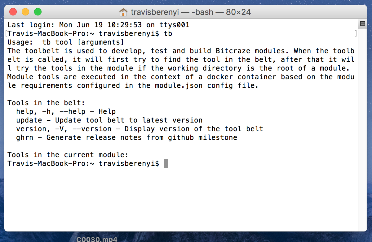

Okay, somehow I got to this step, but I'm not sure which location I "cloned" the firmware code. I'm so close to getting this working.
Hopefully the tutorials above will help you find the tools you need to find your way around your file system using the terminal.
When you "git cloned" the repository you should get a new directory with the same name as the repository in your current working directory.
cd crazyflie-firmware
should take you to the newly cloned file tree.
