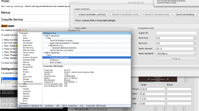

The red light blinks constantly whilst scanning... I tried to open the boot loader but it cant find the dongle even though it shows up in the system profiler, ive attached a screengrab
Thanks guys!
PS ( I cant find anywhere that says that i need a driver for the dongle on osx, is that correct? )

I'm sorry but I'm lost when it comes to Mac. Getting a Mac might be a good first step bridging that
