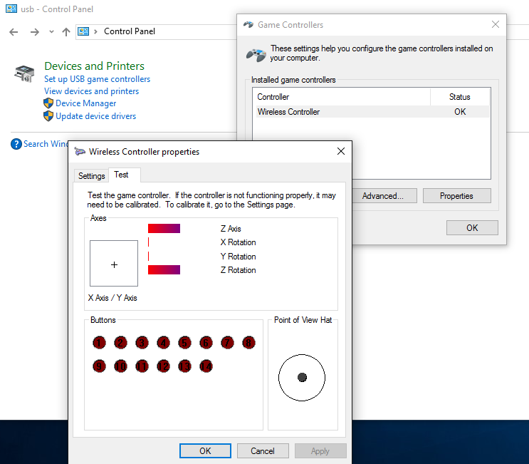

What about in the game controller settings, do you see it?
Did you select it in the client and set a mapping?

yes, I see that too, and the controller works and responses to the tests.
In CF client, under "Input device", all other menu items are disabled except for "Configure device mapping",
then in the dialog, everything is disabled except for the Cancel button.
