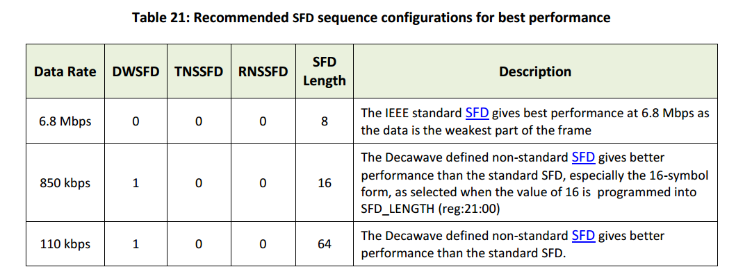

I find the config as following:
and I also check the dw1000 user manaul,
so I think that when data rate 110kbps:
if(rate == TRX_RATE_6800KBPS) {
setBit(dev->chanctrl, LEN_CHAN_CTRL, DWSFD_BIT, false);
setBit(dev->chanctrl, LEN_CHAN_CTRL, TNSSFD_BIT, false);
setBit(dev->chanctrl, LEN_CHAN_CTRL, RNSSFD_BIT, false);
} else {
setBit(dev->chanctrl, LEN_CHAN_CTRL, DWSFD_BIT, true);
void dwSetDataRate(dwDevice_t* dev, uint8_t rate) {
rate &= 0x03;
dev->txfctrl[1] &= 0x83;
dev->txfctrl[1] |= (uint8_t)((rate << 5) & 0xFF);
// special 110kbps flag
if(rate == TRX_RATE_110KBPS) {
setBit(dev->syscfg, LEN_SYS_CFG, RXM110K_BIT, true);
} else {
setBit(dev->syscfg, LEN_SYS_CFG, RXM110K_BIT, false);
// SFD mode and type (non-configurable, as in Table )
} else {
setBit(dev->chanctrl, LEN_CHAN_CTRL, TNSSFD_BIT, true);
setBit(dev->chanctrl, LEN_CHAN_CTRL, RNSSFD_BIT, true);
uint8_t sfdLength;
sfdLength = 0x08;
} else if(rate == TRX_RATE_850KBPS) {
sfdLength = 0x10;
} else {
sfdLength = 0x40;
dwSpiWrite(dev, USR_SFD, SFD_LENGTH_SUB, &sfdLength, LEN_SFD_LENGTH);
dev->dataRate = rate;
}if(rate == TRX_RATE_6800KBPS) {
} else {

I don't change the two line code, my rxtimeout time too short result in communication fail, add the timeout to ~20ms, pass.

Ok, so the current code works for 110kbps, good to know. Thanks.
