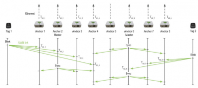

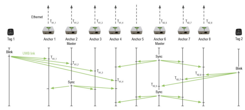

or I also see the traditional TDoA as following, http://www.sewio.net/rtls-tdoa/technolo ... f-arrival/
if realize it, Please provide some advice.

The drawing you are sending look more like an asset tracking setup where the tag is typically battery powered and sends "blinks" at random 'large' intervals. This should be possible with the LPS hardware but requires to write the algorithm for it. If you want to keep the kalman filter this is also not the best solution (the tag in that case do not get the position).

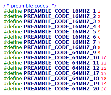

so if two groups system, tag0 and anchor1 set the preamble code is PREAMBLE_CODE_64MHZ_9, another group tag7 and anchor2 set the preamble code is PREAMBLE_CODE_64MHZ_12, they can communicate without interference ? but the peramble code only the following 20 groups,
if I have 1000 tags, always generate the conflict.

For the preamble you will just multiply by 4 the possible bandwidth (you can only use 4 different channel/preamble for your 4 anchors). So it helps a little bit the scaling.
