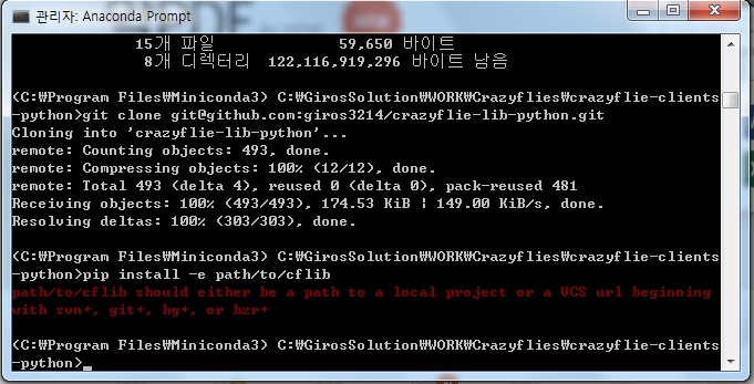

these error is from installing cflib in terminal in ubuntu and adnaconda in win7
$>pip install -e path/to/cflib
path/to/cflib should either be a path to a local project or a VS url beginning with svn+,git+,hg+,or bzr+

Finally the line "pip install -e path/to/cflib" Does not make sense to copy-paste like that. You need to replace "path/to/cflib" by the actual path to the lib. Asuming you have activated your conda environment the following sequence should work to install cflib from source:
I suggest you read some documentation for pip and more generally about python if you want to start developing on the crazyflie lib and client.
git clone https://github.com/bitcraze/crazyflie-lib-python
cd crazyflie-lib-python
pip install -e .
