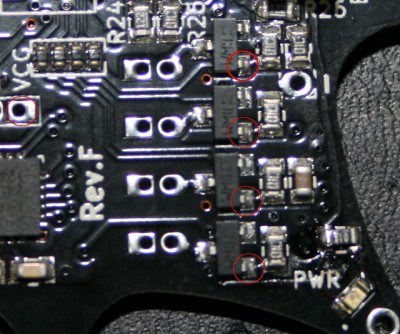

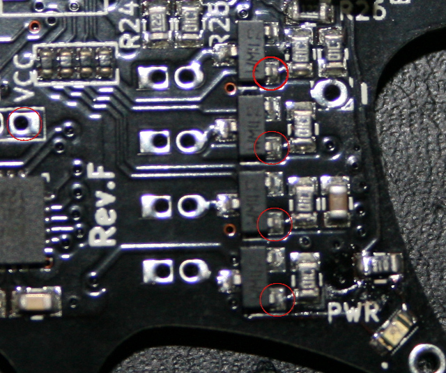

You could manually test each driver by enabling each motor driver transistor. This can simply be done by taking a wire and shorting the gate leg of the MOSFET to VCC. The MOSFET gates and VCC are marked in the picture. The board must be powered from battery for this test to work, and don't do the test with propellers on, it can hurt ;).
