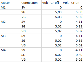

Here are the values given by the voltometer:
Seems like the values of the M1 connection doesn't change during startup..

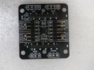

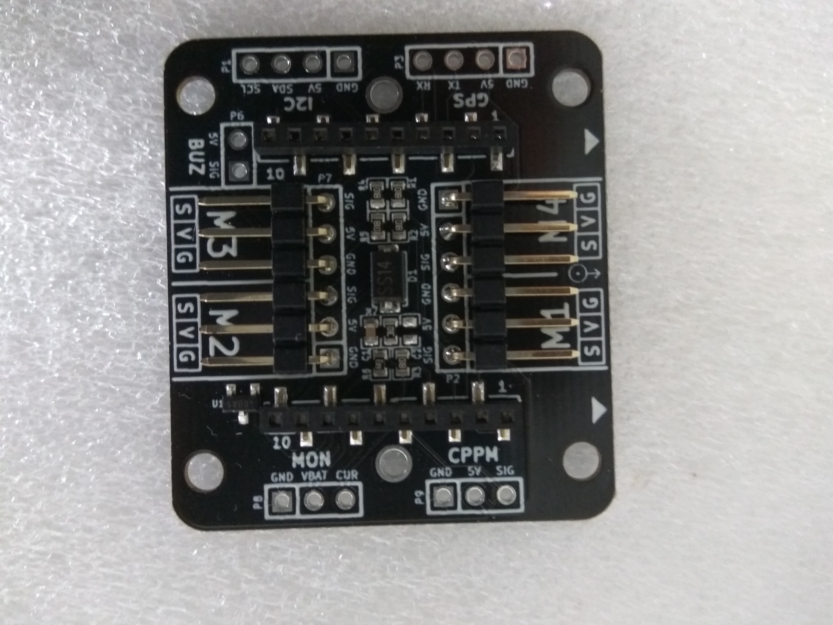

I had a closer look at the board and hit on something, showed in the red circle. Does these soldered point should be unused/free?
Konstantin
- Posts: 17
- Joined: Fri Aug 05, 2016 7:57 am
Re: BigQuad - All fine, just M1 is lazy
Okay, i solved the problem! I noticed, that the soldered point on the CF board had an unstable/broken connection to the connector. I fixed it by soldering and now it's flying! Well, the PID values seems to need some adjustment, but hurray, it works!!
