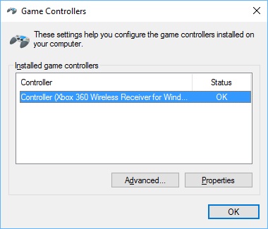

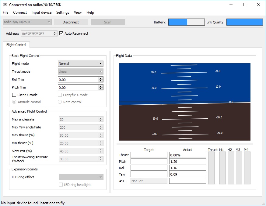

I am running the crazyflie PC client 2016.4 on Windows 10. I can see the dongle and connect to the crazyflie copter no problem but the client cannot see my xbox controller (No input-device found, insert on to fly). Windows can see the controller and I can verify that the controller works with windows.
What am I doing wrong here?

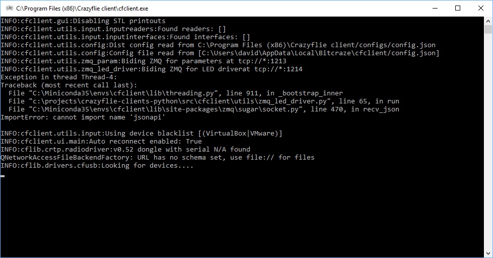

Well that's good to know. I tried the current dev build on github, the 2016.4 build, and a 2014 build that I received from a professor. The 2016.4 build has the input-device issue, the dev build crashes upon startup, and the 2014 build fails to link up with the crazyflie.
So I abandoned the windows build for now and switched to OSX.
