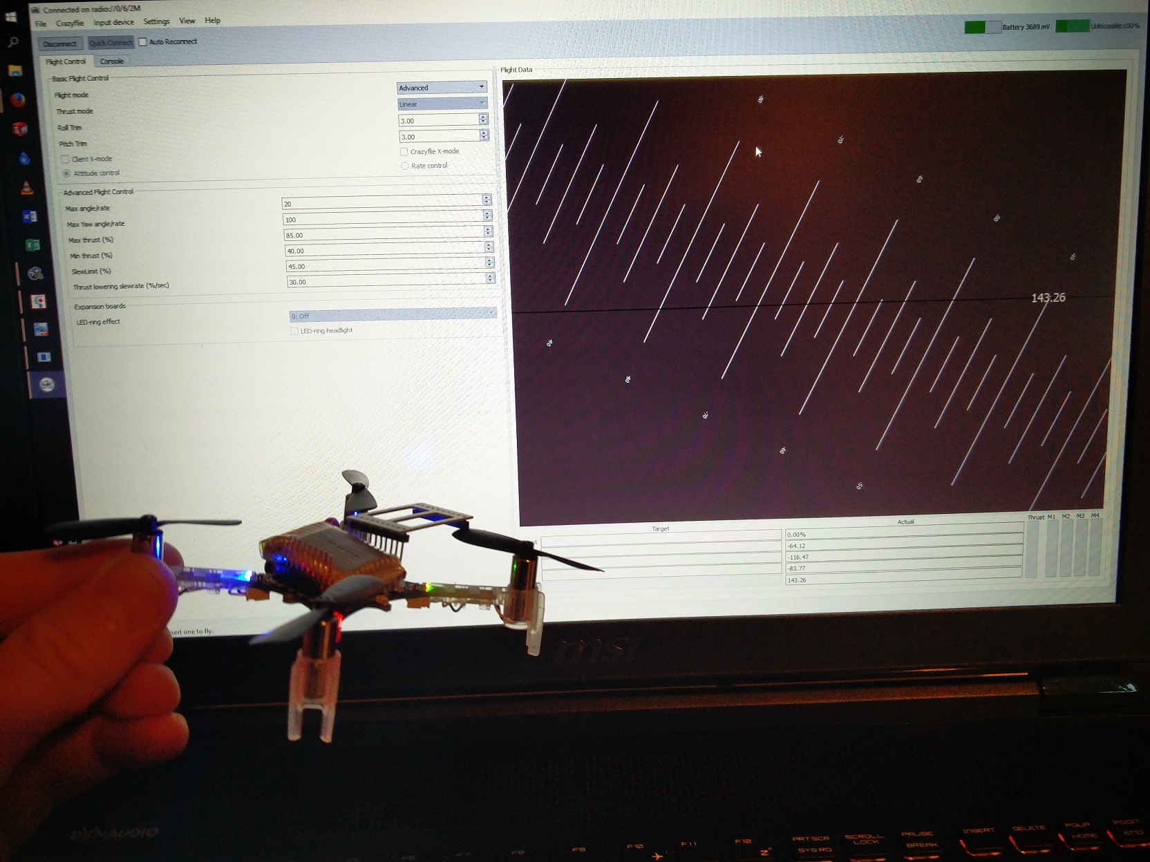

I was having issues with my Crazyflie 2.0's gyro. The gyro would either be accurate, or it would be drifting wildly as shown in the attachment.
I tried to reflow the MPU9250 as described in
- asnelt's post here: viewtopic.php?f=5&t=1125&p=9863&hilit=reflow#p9863 (2016 Feb 6 7:47), and
- tobias' recommendation here: viewtopic.php?f=5&t=1245&p=6849&hilit=reflow#p6849 (2016 Jan 28 11:17).
After using hot air on the MPU9250, I saw better results for a couple flights, then I saw the problem again. I tried to reflow the MPU9250 again, but burned some components.
