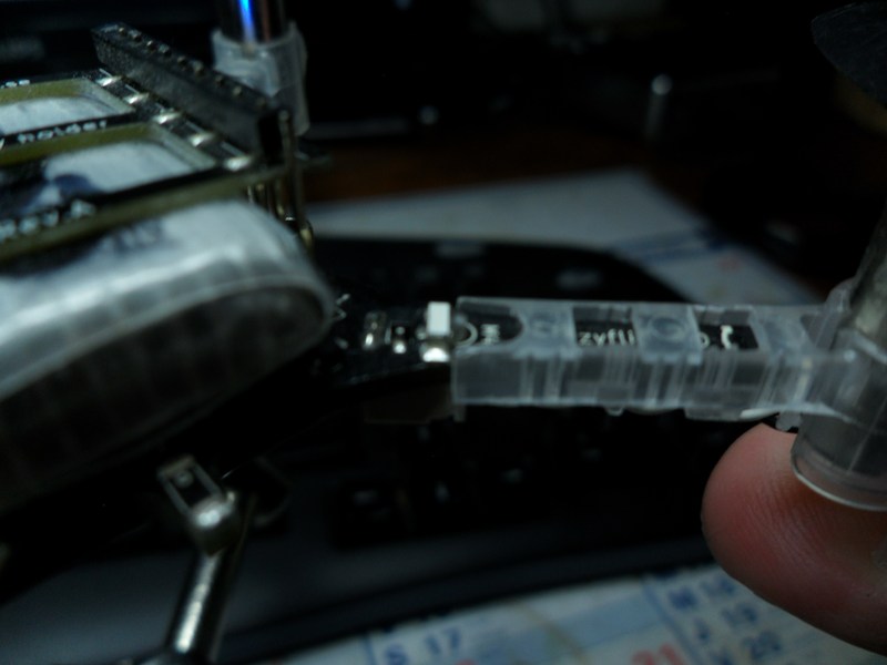

I have a new machine for a few months. Now, the bad contact is for th M4 (transmission) LED. I will not try to repair because I lost one machine with wrong soldering attempt...
Re: Electrical contact failure
Could you take a makro photo of the M4 LED. Maybe we can spot the problem and hopefully there is an easy fix?

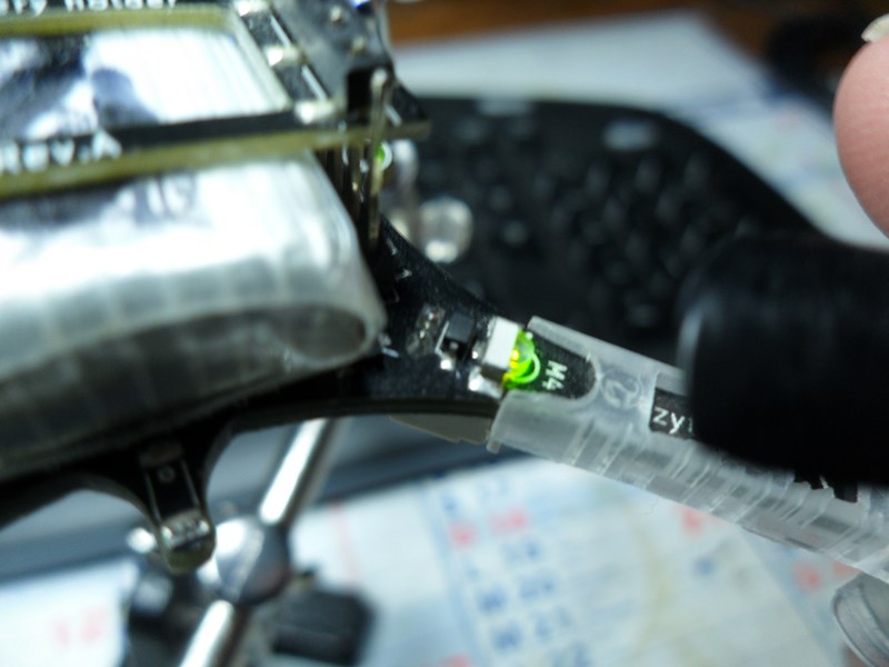

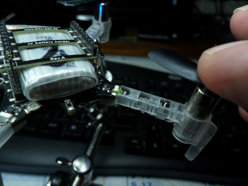

Hi Tobias
The quad is connected.
When I push up the M4 arm, the M4 led is off.
When I push down, the led blinks red/green, which is the right behaviour.
See photos. On the third photo, the LED is OK.
I don't think that there is a solution. Nothing is visible on the PCM.
Jean-Claude
Then I don't suspect that the trace has actually cracked but that the solder to the LED is to blame. I think it should be fixable by quickly just melting the solder on each pad of the LED.
