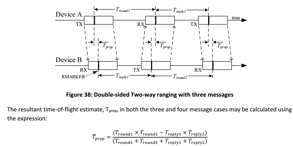

(2)From the dw1000-user-manual, we find the formula,
But we should more easily understand the 12.3.3 Using symmetric reply times formula:

(1): The formula in the code is from the decawave documentation you are copying. We did not re-prove it but it works :-).
(2): The second formula, as you noted, is using symmetric reply time. This is accurate only if the reply time is the same in the tag and the anchor. This adds a hard requirement and if this requirement is not fulfilled (ie. if the reply times are not equal) the accuracy will suffer. The first formula, that we are using, is more accurate and only assumes that the clock drift between anchor and node is contant for the ranging time.

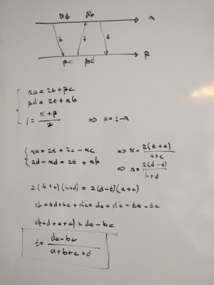

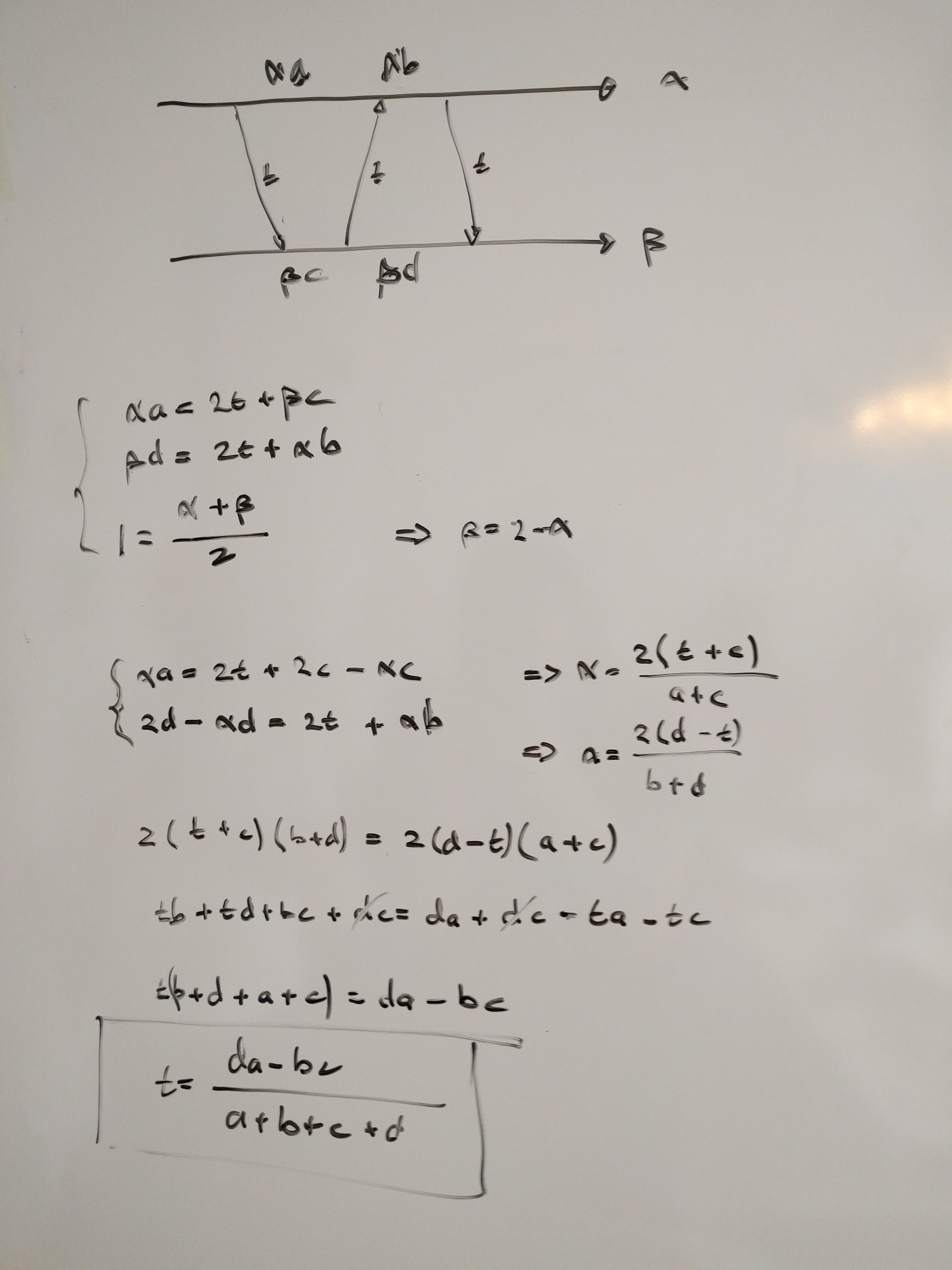

By the way, Kristoffer here at the office really wanted to prove the decawave formula and so he did. If you assume that the clock of one of the node is off by alpha and the other by beta, the key was to find the time of flight in a "virtual" clock that would be the mean value between alpha and beta, here is it:
So for example if both clock are off by 10ppm, the measurement will be off up to 10ppm independent of the time it took to make the measurement. a couple of 10s of ppm is very good when it comes to distance measurement :-) (off course there is other factor but at least we get rid of the clock drift difference between nodes which was a major error source with the other formula).

But why Alpha plus Beta = 2 ?
Posts: 2538
Re: DWM1000 DS-TWR method calculate distance method?
Post by arnaud »
This was the trick to get the same formula as decawave :).
We take alpha and beta the factor by which each node clock is drifting. Then we define 1, a perfect clock factor, as being the mean value of alpha and beta (third equation of the system). This leads to alpha+beta=2.
