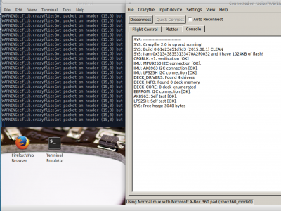

Let me start off by mentioning that I'm using a Macbook Pro. I am able to get my Crazyflie 2.0 connected to the Crazyradio PA dongle. However, after connecting I get this persistent warning dialogue like so:
I'm a beginner to all this and would really appreciate some assistance with this problem, That's only 1 of my many problems. I'll post the other problems soon.

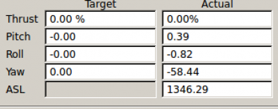

I don't know how to find a clear wifi channel. I'm still getting the Warning dialogue when connecting, I'm assuming that isn't how it should be. Also, the "Actual" Yaw value keeps climbing.
If i read correctly the .zip file is the correct one to flash.

The correct file to flash ends in .bin, not .zip.
Yaw value will keep climbing, that's normal, it's called yaw drift.

I flashed the .bin file at the link you mentioned. I used the Mac Wireless Diagnostic Tool and selected one of the best 2.4 GHz connections. The information on the console was this:

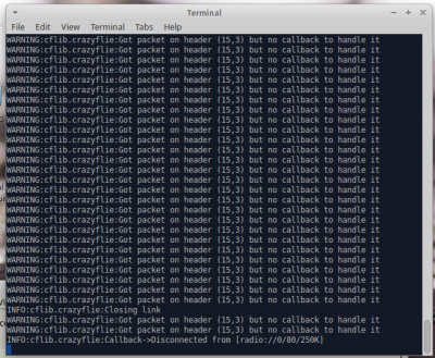

Hi! I'm having the exact same problem. This warning keeps popping in the console of the client.
I'm using a linux pc (ubuntu 14.04), and I'm running the client from the official VM, version 0.6 (a fresh install). I'm running the client by double-clicking the desktop icon. But if I run an example (e.g., basicparam.py) from a console, the same happens. I updated all the proyects and the Crazyflie 2 firmware (to crazyflie2-2015.08.1). I'm using a logitech controller, but that seems to be completely unrelated. The crazyflie flies just fine (well, it drifts too much to my taste, and I can't get it to stay on the air for more than a couple of seconds, but that's probably my lack of expertise..).
Ask me anything you need to know to troubleshoot this.

This is my fault and it has been fixed in the develop branch of the client. This warning is not important so much that my fix was just to remove it: https://github.com/bitcraze/crazyflie-c ... 5dc420L394
The origin of the problem is that I added a packet to return the signal strength from the copter, I piggy packed the signal strength on a NULL packet (the packet (15,3)). This should just be ignored by the client until we use it but instead a warning was printed.
The curious thing is that if you run the last released Crazyflie firmware (the .zip from github https://github.com/bitcraze/crazyflie-r ... /2015.08.1) with the latest released client (the master banch) you should not see this.
If you use the trunk firmware for stm32 and nrf with the client from the develop branch you will not see this warning either.
