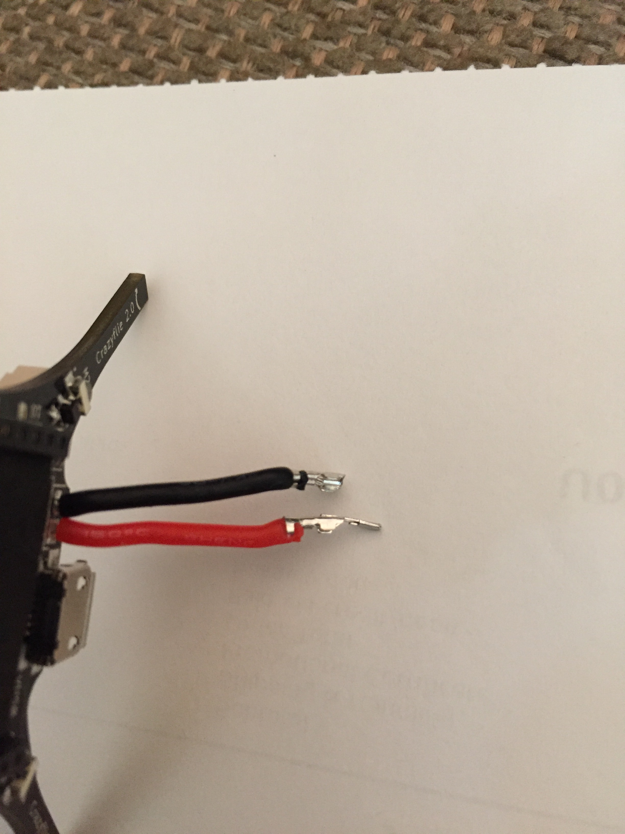

Hi everyone, hoping to have help with the following scenario. Apologies if the terminology is incorrect; however, I've attached a photo to the message.
The metal tips on one of the battery connectors broke off. Failed Google searches have led me to this forum to see if the community can point me in the right direction as to replace the metal tip, the plastic connector and then I'm off and flying again.
Thanks!

The connector is a Molex 51005-0200. However putting new crimp pins on there is probably harder then finding a new cable with wires and connector and solder that on instead. With a bit of internet searching you should be able to find cable assemblies.

Thanks Tobias. Will see what I can find for both the crimp pins or a pre-crimped wire.
