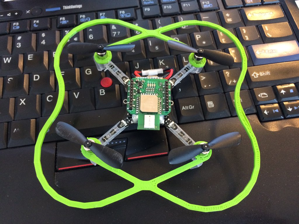

If you have a 3-D printer, you can download the STL file from Thingiverse:
http://www.thingiverse.com/thing:1151252
I created this based on a different model, and modified for the CF2. Note this will not fit the original CF. Printed on a Flashforge Creator Pro, 0.4mm nozzle diameter, BPA plastic. No z-axis protection, so fly carefully :D
Adds 5 grams of weight if printed with standard BPA (white).

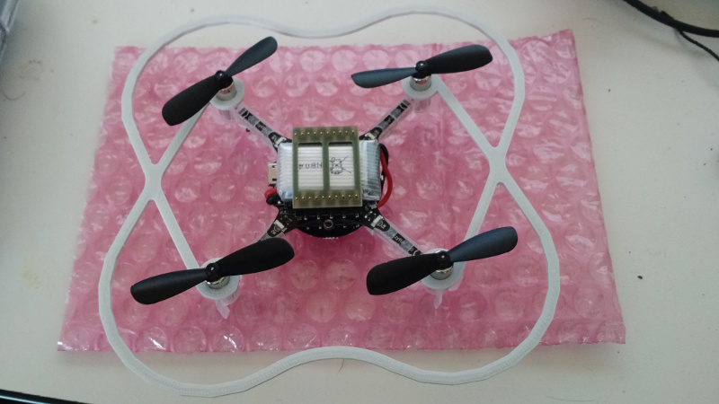

Posts: 2538
Re: Prop Guard for CrazyFlie 2
Post by arnaud »
I printed it, it looks nice and works great! Thanks for sharing.

buildsrobots
Posts: 19
Joined: Mon Sep 28, 2015 11:59 pm
Post by buildsrobots »
arnaud wrote:I printed it, it looks nice and works great! Thanks for sharing.
Looks pretty cool in that color. Thanks for your help with my questions :D
