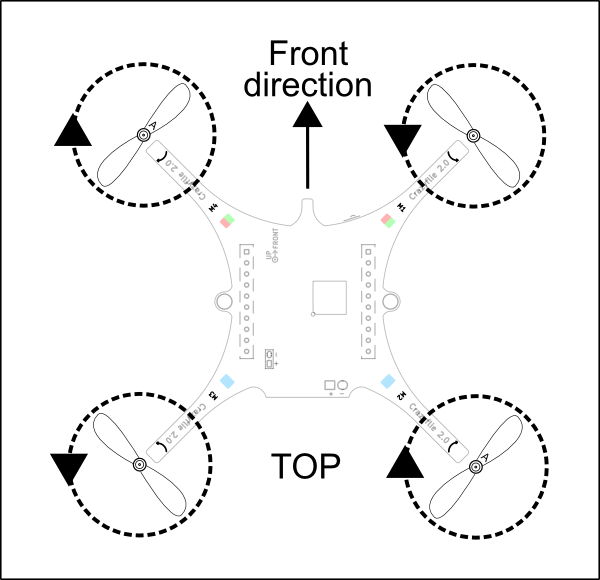

I checked the propellers rotation several times (according to https://www.bitcraze.io/wp-content/uplo ... _props.png ) and they seem fine.

Which client app are you using? PC client, Android, iOS?
Just to double-check, please make sure that you can see a little "ring" on every propeller's center as seen on
otherwise your props are facing the wrong way.
And another test: what happens if you hold the Crazyflie with two fingers at the end of one arm (on the plastic motor mount), letting it hang down and carefully (!) increase thrust? (it should try to turn upright)

Thanks Fred, I had mounted ALL the propellers on the wrong side.
It works now!
