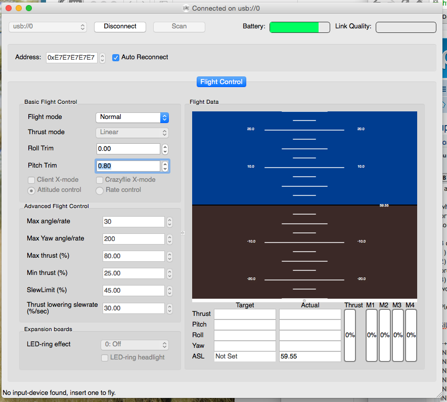

also, when I physically lift the copter by hand the "Flight Data" area is reflecting that I am moving the copter and changes the pitch/roll/yaw fields also. But at the bottom of the screen it says, "No input-device found, insert one to fly" - See the attached image.
Please advice. Thanks. (See screen shot of control Panel also)

Those messages you see reflect that the python client is looking for a controller. That is, to use the python GUI client, it expects you also have a PS3, PS4, Xbox, or other similar controller plugged in. If you are seeing flight data coming in and the artificial horizon on the GUI is matching your motions, then the Crazyflie is communicating with the GUI client.
As far as "commands" to spin the rotors, please have a look at the files in crazyflie-clients-python/bin. Specifically the ramp.py example. That contains what your are looking for. They do not use the GUI however, they are simply python script examples to operate the Crazyflie.
Hope this helps!
