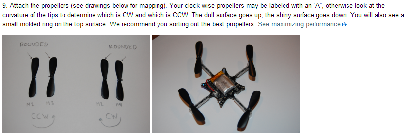

Another question might be if you chose props from both of the packages or one package. The difference between the two sets of props is subtle, and you need two of each type, in alternating arrangement as described. Perhaps the bags could be labeled.
First time I ran mine with props, I was careless thinking they were all the same and added them all from one package. The result was the same, no lift!
Choosing M2 and M4 from the unused bag, I was in the lift business!
Just a thought!

All of my props on the drone build are marked "A". Let me try different props and see if this works.
I saw no instructions on props type though. Maybe I missed it.

Yep, this is what it was. Two of the blades need to be from the other pack. I'll try this tonight. Looks like you guys probably solved my flight issue. Thanks so much!

Solved. I needed M2 and M4 to be on the reverse direction of blade.

I had exactly the same issue as rmirwin2. Maybe this should be explicitly addressed in the documentation?

Re: [SOLVED] Drone cant get enough power to take off
Er... it is:ApolluX wrote:I had exactly the same issue as rmirwin2. Maybe this should be explicitly addressed in the documentation?
