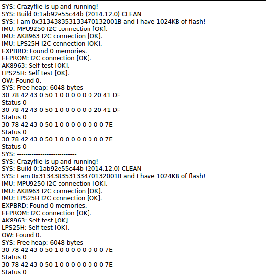

I have a CF2. It has been flying fine for the past week or so. A few days ago, I turned it on and connected it to the VM. As soon as I increased the thrust to a slight launch, the CF2 wants to go left. The more thrust, the further left it goes. At around 60% thrust or so, it flips(to the left, of course). I replaced the two left-side motors and props. I have tested the gamepad to rule out connectivity or gamepad issues. I set the trim to a number of levels to no avail. Every time I start the thrust, the CF2 wants to go left, no matter what I do. Please help!

Here is a screenshot of the console when connecting to the CF2, changing the trim, and restarting:
Console Screenshot
Console Screenshot

Never mind, never mind. Turns out the props were in the opposite spots. Just for future reference, https://wiki.bitcraze.io/projects:crazy ... e:assembly shows you how to fix it. Right down near the bottom.
