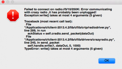

Hi
I finally managed to get the client up and running (although only by dragging it into terminal, not by cd ing and running it directly).
PS3 controller is also alive.
but i cannot connect the cf via crazy radio. And I get this message
thanks a lot for help...

It looks like from the screenshot you posted that the client you're using is quite old. First, how about updating that and then we can see where to go from there. The latest release (as of this writing) can be found here.
