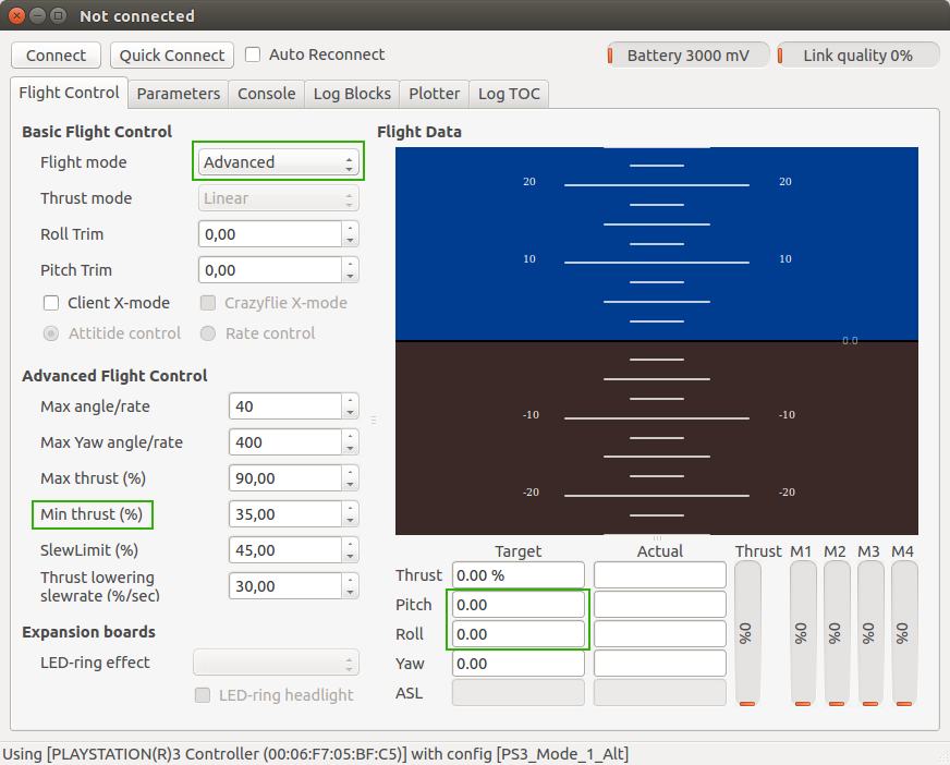

I would start checking if there is hair stuck on the motor or if the prop is to close to the motor. During the start up the motors spin, try to see if the motor doesn't spin as long as the others.
It could also be that the controller doesn't center well. Check the target values in the flight tab. There you can also configure min trust etc in advanced mode. If the CF2 takes off and doesn't directly spin out of control they are most likely mounted correctly. Check that they are balanced if you haven't already done that.

I have checked, nothing is stuck, the motors has adequate spacing from the propellers, the motors spin together, the propellers are soldered in their configuration, M1-Clockwise, M2-Anti_Clockwise, etc.
I have also tried out advanced filght mode but it doesn't seem to have any difference on it too.

Supplying just enough thrust causes it to also lean towards a certain direction even when no roll, pitch or yaw values are indicated on the PC client.
The difference is that the values do in fact, change when at rest and the analog sticks are moved.
