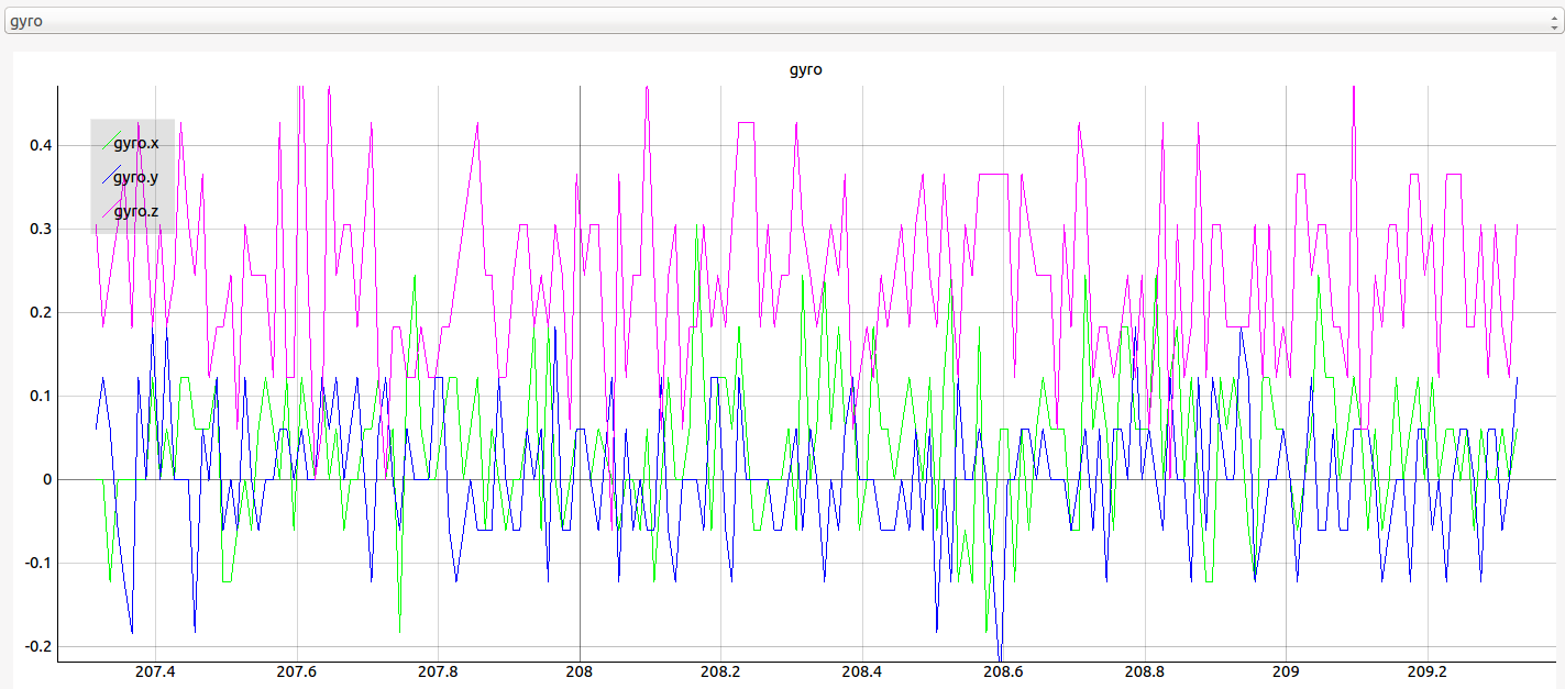

Re: Error in Sensor readings?
I don't think the gyro values are wrong but because of quantization. The value is converted from a 16bit value and that is why you see 0.0 sometimes.
Plotted gyro values
Plotted gyro values
