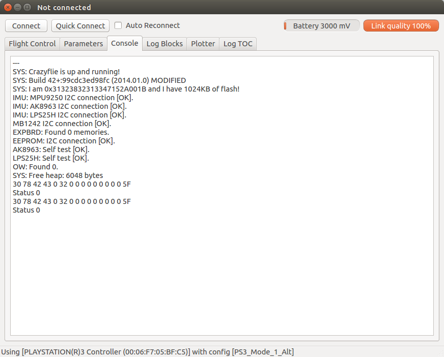

Then the next thing to test is if sensor communication fails during flight. That you can see in the console output tab and you should be getting some I2CDEV: Error callback nr: 1024 printouts.
See below picture showing the console tab. Can be viewed by view->tab->console.

I see I'm missing
MB1242 12C connection
Thanks
Dins
Thanks
Dins
Re: Confused Newbie
Ah its because I was helping out in another thread were one wants to attach a ultrasonic distance sensor and a took the screen shot using the firmware.I see I'm missing , MB1242 12C connection
You output looks OK so then we have to try to find out if something happens during flight. Fly the Crazyflie until you see the erratic behavior then get back to the console and see if you get something similar to the console output below. You should be looking for I2CDEV: Error callback nr: 1024 marked in bold.
