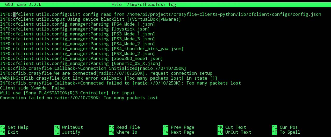

After booting Raspberry Pi 2, When I connect PS3 Controller and Crazyradio Pa. Nothing happens.
cfheadless.log file:
Where is the problem ?

Is your Crazyflie actually on channel 10 at 250K? If not, you'll need to edit the "link" file.

THX chad, I've changed the Channel from 10 to 80, and the problem was solvedchad wrote:Is your Crazyflie actually on channel 10 at 250K? If not, you'll need to edit the "link" file.
