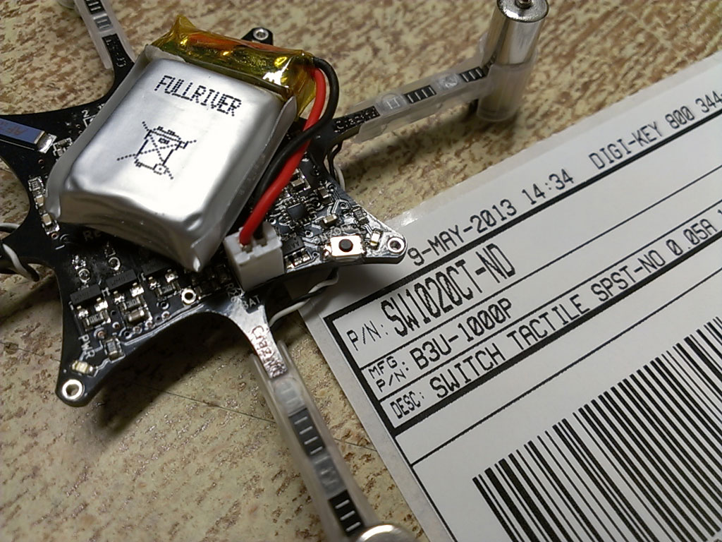

I went with the B3U-1000P switch at about $1. It tends to be a more sturdy built. The turning on and off process feels much better then the original.

T50Japan wrote:I went with the B3U-1000P switch at about $1. It tends to be a more sturdy built. The turning on and off process feels much better then the original.
Glad to see it's fixed. We actually tried this switch for a couple of prototypes but the problem was that we couldn't turn the Crazyflie off if the propellers were spinning :shock:
