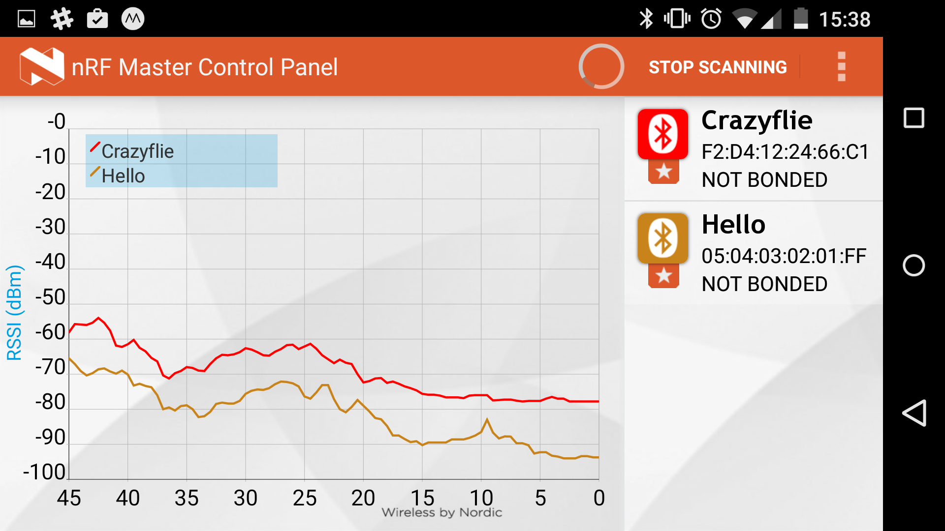

How are you measuring the RSSI? We observered a great increase in range when adding the PA, though it is not so useful when communicating with BLE devices as the TX power of BLE phones will still be around 0dBm.
The Bluetooth tx power is actually handled separately by the BLE stack and has been 0dBm all along (so +20dBm after the PA). When measuring with an RFExplorer in max-hold mode I get -10dBm with the Crazyflie and -26dBm with a dev kit that is set to 0dBm in similar condition, which looks OK (considering the different antenna and tolerances in components). When measuring with a phone (Nexus 5), when close to the devices both look like they have similar output power (Crazyflie is above but the powers sometime cross), however when going away the Crazyflie clearly have more margin (see screenshot). Note that this screenshoot was taken just before the advertising was lost and both got lost almost at the same time even with the link margin. This is because the phone is sending requests to an advertising device with about 0dBm and the Crazyflie LNA (RX amplifier) does not seems to help very much here.
