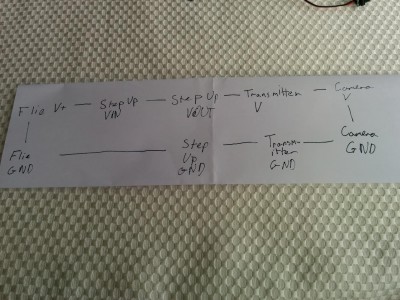

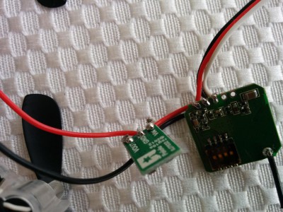

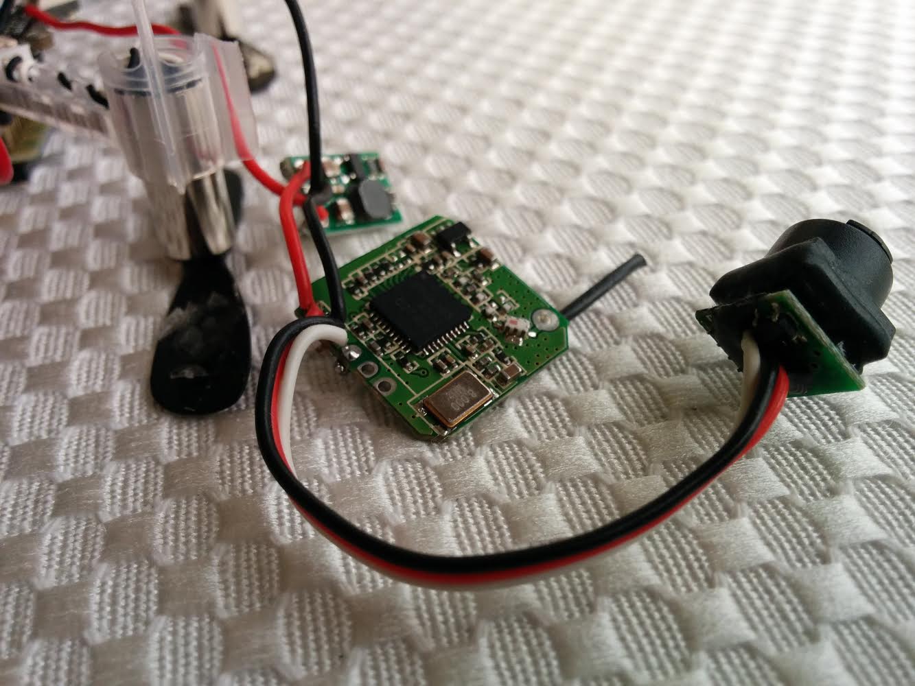

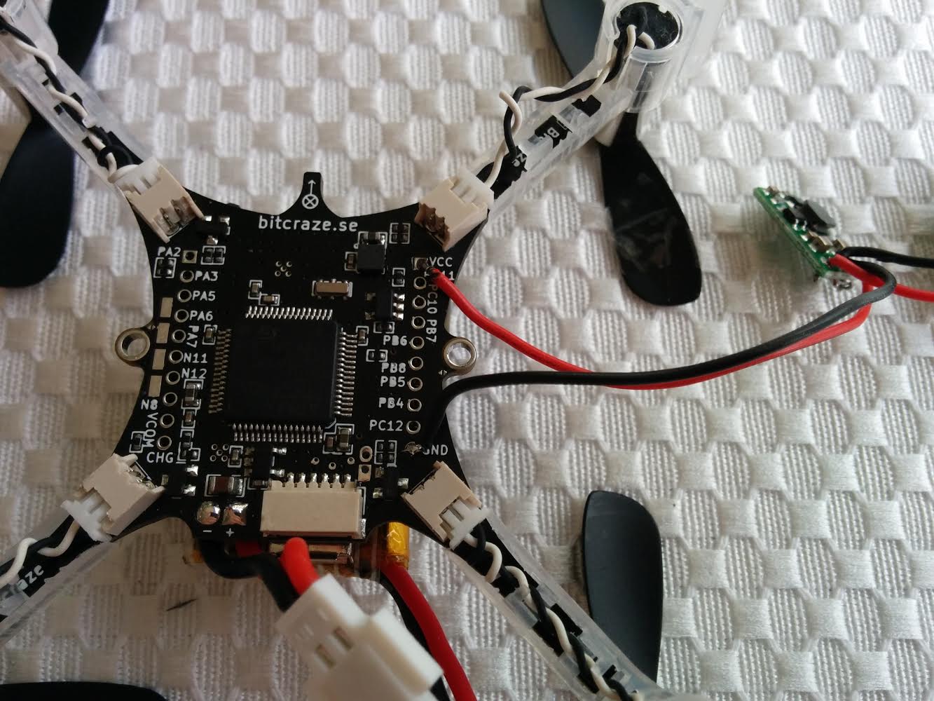

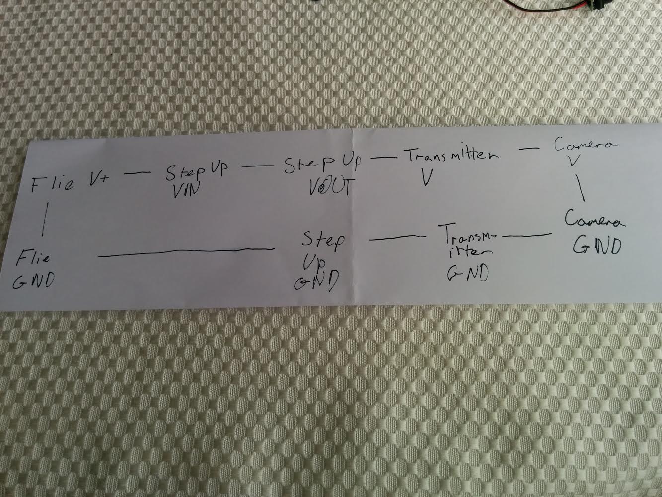

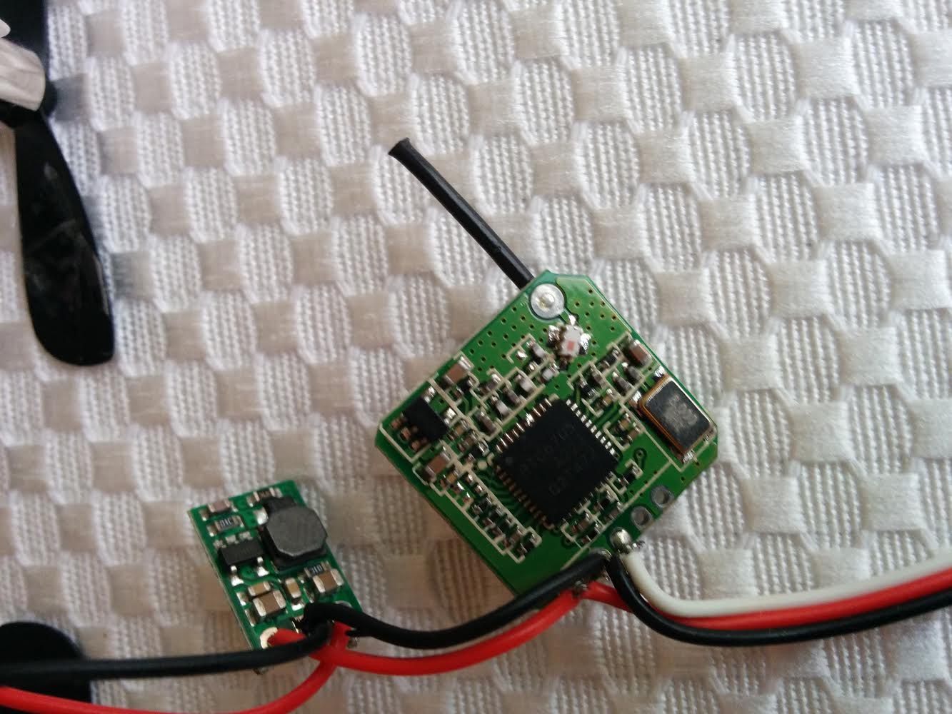

Ok, so here are some photos I took of the circuit, along with my shitty unskilled "circuit diagram"
EDIT: Probably should link to the set. They shipped a slightly different transmitter to the one listed, so thats why my wiring is different.
How its connected to the flie: The Step Up regulator connected to the transmitter, 2 photos, the ground on the step up is a passthrough: The transmitter connected to the cam; the voltage and ground on the transmitter are passthroughs My shitty not-proper diagram.

Tipping would suggest IMU involvement, how is the telemetry in the client?
Maybe could be current related also? What is the FPV rig drawing when running/transmitting?

Re: Crazyflie 2.0 Tipping forward when fpv added?!
It might be that VCC is overloaded. Have you been able to measure the current consumption to the FPV rig? A pretty easy test would be to disconnect just the VCC cable and fly with the FPV system off to test if it is the same behavior.

Checking with a meter set to Amps between VCC and step up VIN (instead of the wire) would be a good shout.tobias wrote:It might be that VCC is overloaded. Have you been able to measure the current consumption to the FPV rig? .
As a thought... (I'm not sure, maybe Tobias could insight?) what about taking power from vcc and VUSB?
Also, did I see that your transmitter can run between 3V - 5V? What about doing away with the step up altogether?
Warning - These are thing I would try but I am not qualified or trained in Electronics so Please heed at your own risk
- Posts: 2538
Actually (correct me if I am wrong Tobias ; -) this kind of circuit should be connected to VCOM, VCOM is the battery voltage after the power management chip, this is from this voltage that VCC is generated. Getting a lot of current from VCC is not advised, it has a 150mA regulator and the CPU alone will takes at least 40mA.
Yes the best thing would be to use a VCOM if the step up can handle an input of 5v when the output should be 5v.
