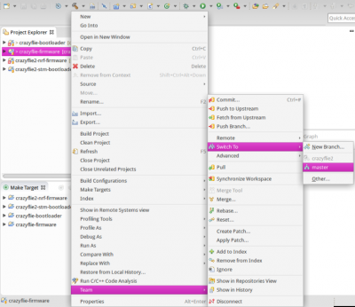

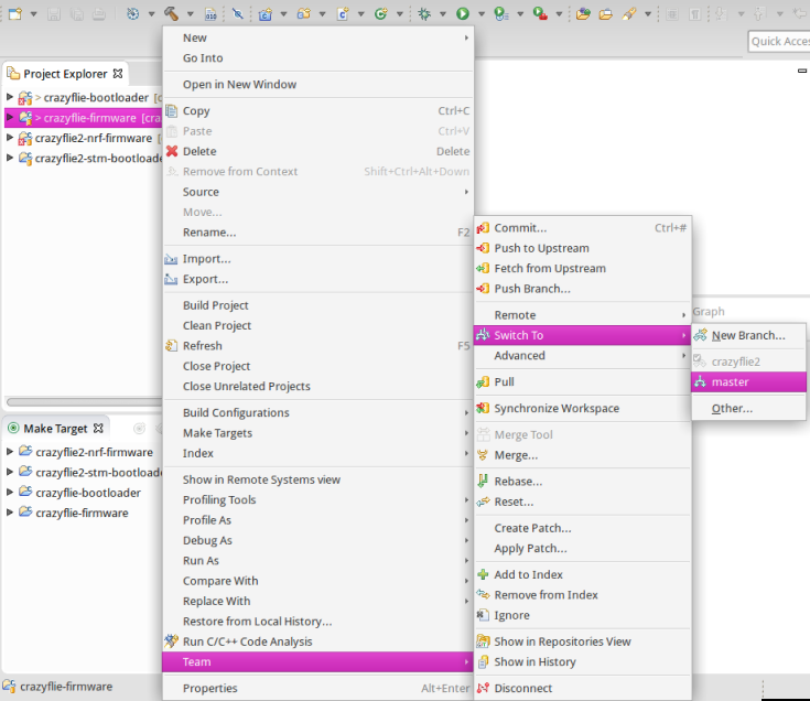

I believe the 0.6 VM has the crazyflie2 branch checked out by default. Crazyflie 2 firmware is on separate branch and has not yet been merged into master.
In Eclipse, you can right-click the "crazyflie-firmware" project in the "Project Explorer" section of the main window and go to the "Team" menu item near the bottom of the menu. Select the "Switch To" item and finally choose "master." Run the "clean" target, then run the "Make CLOAD" target, and finally "Flash using radio" and your firmware should work.
Let us know how it goes. :)
