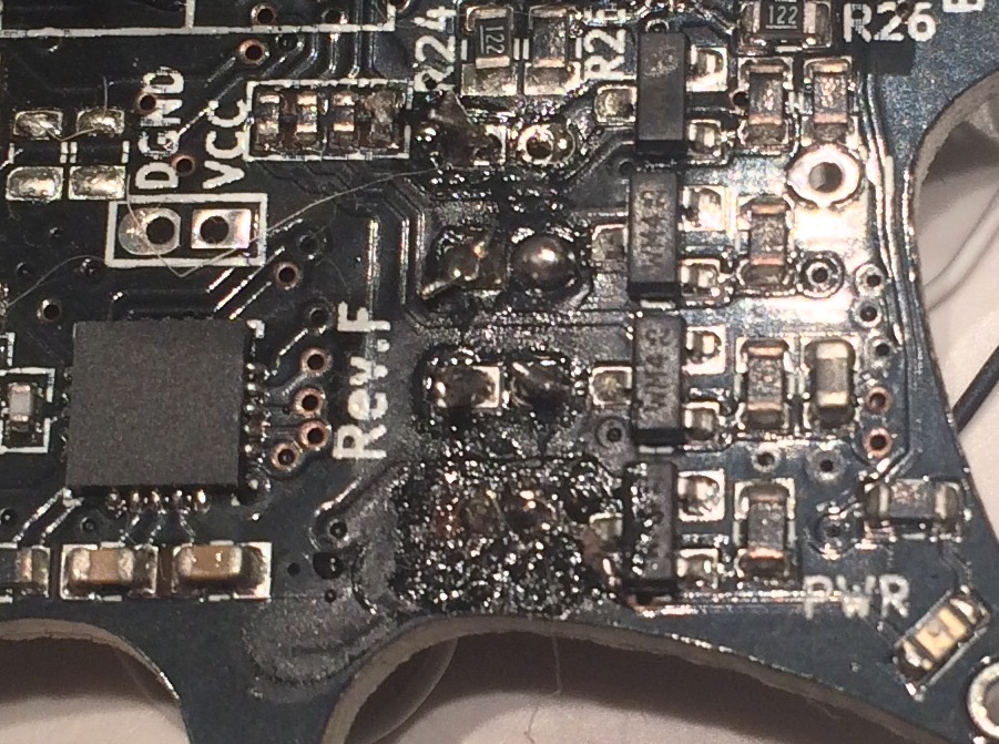

lordofllamas
- Posts: 7
- Joined: Tue Jan 20, 2015 11:54 pm
Re: Crazyfile motor not working
Hi Chad!
Here's the image.
[img]
https://mail.google.com/mail/u/0/?ui=2& ... w1269-h539
[/img]
The problem is at motor four, the circuit has a lot of burns and the transistor to the right is burned a bit.
Thanks.
Here's the image.
[img]
[/img]
Thanks.

lordofllamas
- Posts: 7
It's working fine for me...
EDIT: I saved it and put it up here.
EDIT: The bottom one is motor 4, all the others work.
I'm guessing there is a short around M4 soldering. I would start by cleaning it up with a cotton swab and some alcohol (isopropyl, IPA, is often preferred). Then in this thread there are some posts about testing for shorts and such. Tell us how it goes.
