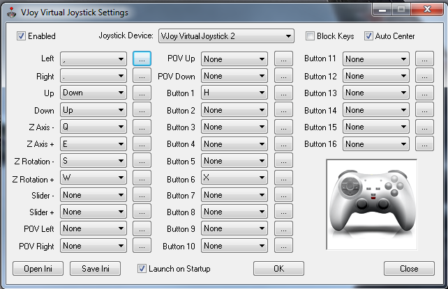

STEP 2: Once done installing VJoy, you can start configuring your custom controls, say for example, the one shown in my screenshot , scrn1
Screenshot 1 - configuring VJoy

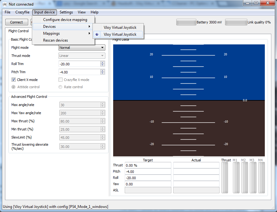

STEP 3: Okay, now for the next step, open the Crazyflie PC Client and go to Input Device > Device and make sure you have selected the appropriate device, as shown in screenshot 2
Screenshot 2- adding virtual joystick

STEP 4: Configure the device on crazyflie PC client, go to input device > mappings > PS4_mode1_windows. Then go to input device>configure device mapping and configure the device as per instructions from the window. Make sure the correct device and corresponding mapping is selected.
