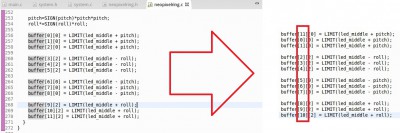

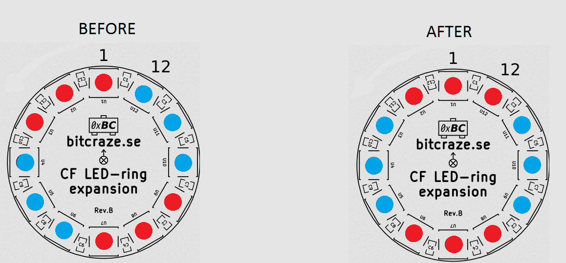

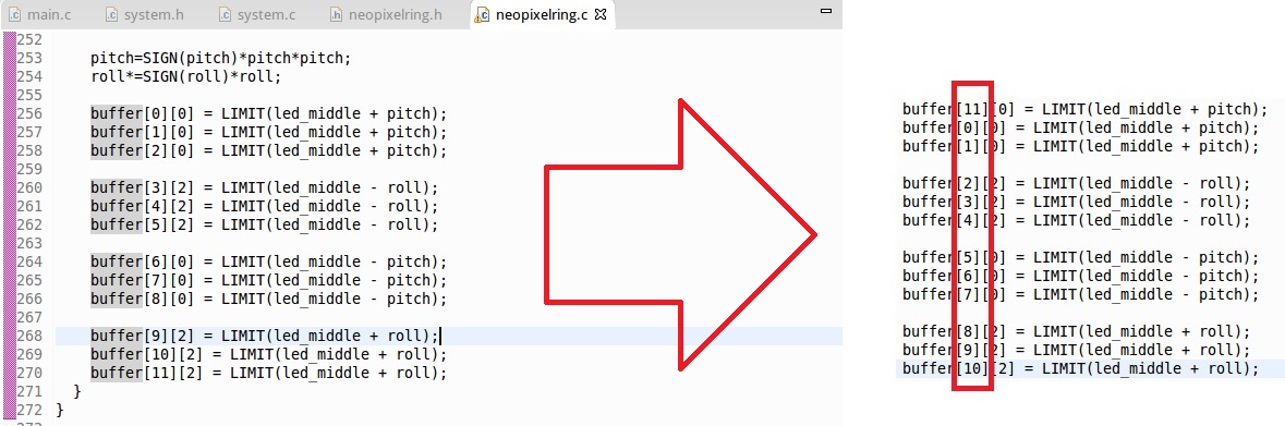

in neopixelring.c there is a small bug on the effect 03 (Tilt Effect).
The effect is working well but the leds are not correctly aligned with the CF
Cheers

Thanks for the feedback and excellent information, I've created an issue on GitHub for fixing this.
