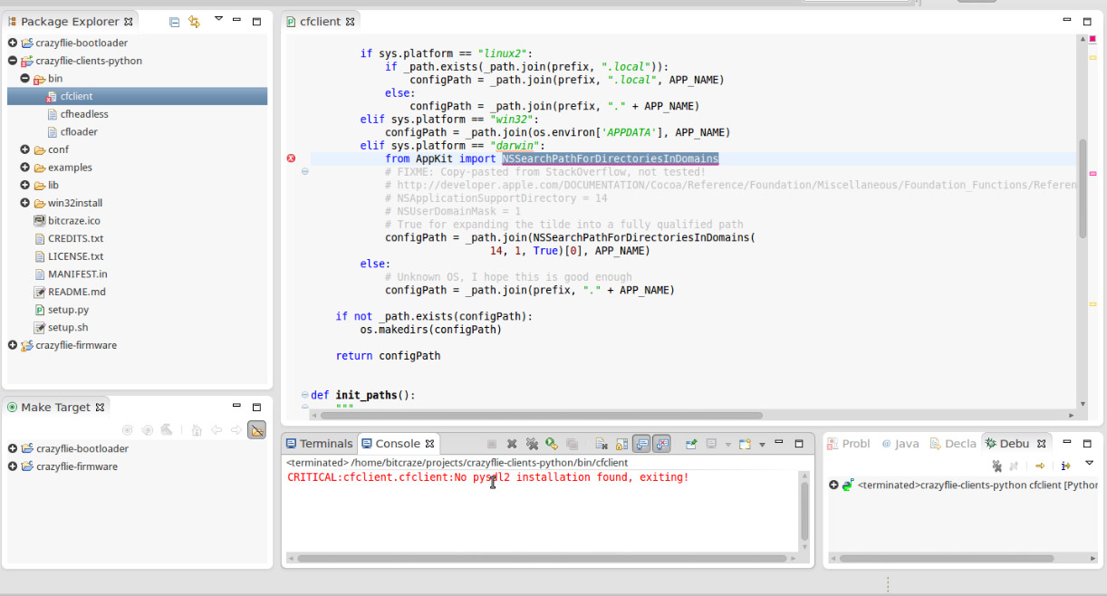

The PC-client version that comes with the VM works fine, however after I run the "Update All Repos" shortcut on the VM desktop the PC-client no longer opens. I am running the Bitcraze_VM_0.5 on my Macbook pro i7 in Parallels.
After trying to launch the cfClient from eclipse (see attached image) I noticed it was throwing an error:
CRITICAL: cfclient.cfclient:No pysdl2 installation found, exiting!
I tried to install pysdl2 using
sudo pip install pysdl2
on the command line, but the error persists.
I also tried building sdl2-2.03 and pysdl2 from source, but it still does not work.
I have reverted to the older cfclient in order to run my CF but I would like to be able update.

The following made it work for me on Ubuntu 14.04:
sudo apt-get install libsdl2-dev
I don't use the VM, but it would be nice if you could try the second command and see if it works out!
