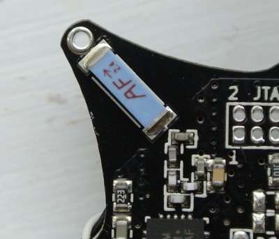

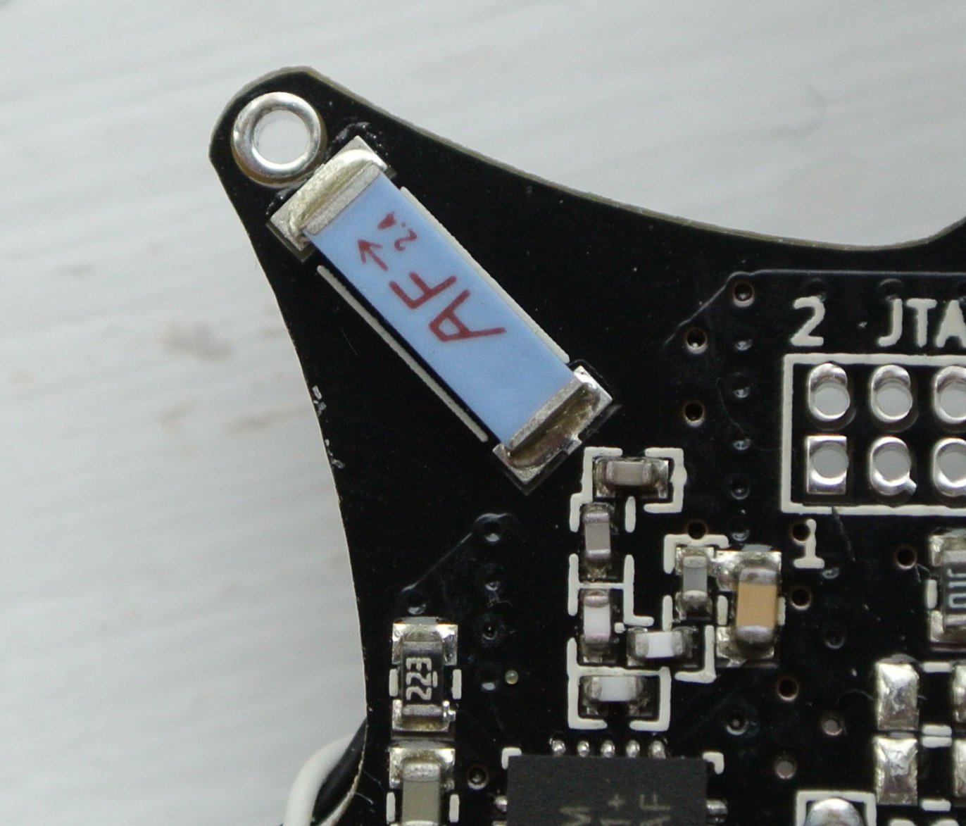

I've built up my CrazyFlie and uploaded the latest firmware via the GUI and every thing seemed to be okay. However, when I move the quad away from the laptop I immediately get the "too many packets lost error". I've tried a large range of radio channels and this seems to make no difference. The furthest range I've managed is about 2m, which I assume is not normal.
I've read the above thread and wonder if there is anything I can do other than remove the ceramic antenna and replace with wire antenna?
I've (hopefully) attached a picture of the quad so that you can inspect the soldering of the parts around the antenna, but it looks okay to me.
Any advise would be appreciated. Thanks.

Re: Too many packets lost error
Hi Andy,
Sorry to hear that you have problems with the radio. No the range should not be around 2m, it should be at least 20-30m. Could you start by contacting Seeedstudio support as they are responsible for the hardware and direct them to your post.
There is a possibility that the Crazyradio or its antenna is the problem so if you have a spare 2.4GHz antenna from e.g. a router you could try that to rule out a problem with the antenna.
I will also contact Seeedstudio as this is the third unit with radio issues in a short period of time.
