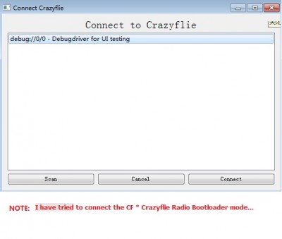

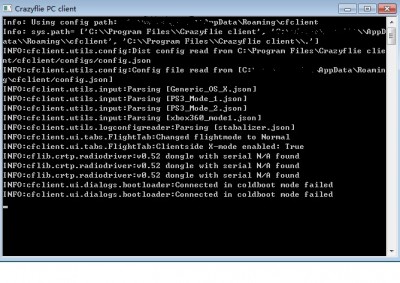

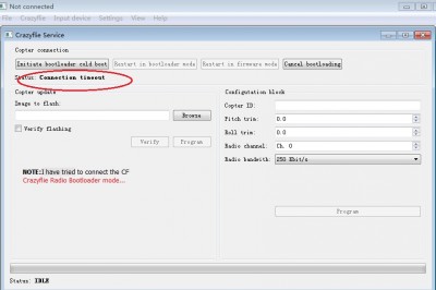

Have you ever managed to connect to the Crazyflie at all (for flying or bootloading)?
no. no .no ...Failed to connect! ... I'm using the " Crazyflie Radio bootloader" (Power up .....standby on two LED exchange flashing in the CF)
* Crazyflie Radio Bootloader
* This program is clocked around the radio activity
* Does NOT work with the stm32-XL (does not take care about the banks)
Have you ever upgraded the firmware for the Crazyradio or the Crazyflie? If you did, then what version?
crazyradio vesrion = 0.52
If you try to connect to the Crazyflie can you see the red LED on the Crazyradio blinking?
yes......the red led flashing..... Client try to connecting CF!!!....... But failed! :(
The following figure:
CF BOOT CONNECT
CF BOOT CONNECT
