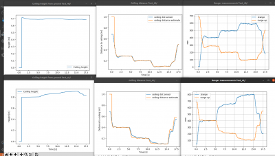

Dear Tobias,
Hereby the data from the ranger log class.
Within the figure you can see two flights again (top row and bottom row), with the following plots: estimation of ceiling height from ground, the ceiling distance estimation from drone to ceiling and the ranger measurements (zrange and up).
Once again you can see the difference between two flight performed using the same drone, same code and same environment. With the drone being switched on and off between flights. Starting from a new battery in flight one and reusing it in flight 2.
What was observed from the flight:
Flight one the drone climbed to the first 0.4 m height and then 20 cm away from ceiling and afterwards 10.
Flight two, drone did not climb to 0.4 as the flight altitude was observed to be lower but the zranger says it reached 0.4. afterwards it climbs to what it thinks should be 0.2 away from ceiling but then the up ranger measures something different and the drone climbs slowely.
It can be said that the zranger is wrong, because the actual height of the table I am flying under is around 70 cm and the zranger in flight 2 measures its flying at 80 cm.
Hope this is clear.

Tricky problem this... If the zranger was the problem it feels like I should pretty easily be able to reproduce it here but I can't. There must be something more to it.
If you manually move it after the power cycle do you also get wrong measurements or is a flight needed.
I guess you don't have another flow deck to test with to rule out any HW problems with the one you have?
Another thing to try, does unplugging and plugging the same battery help?
