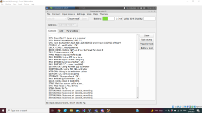

So the problems is related to the flow deck v2 and not the multiranger. And you get the same error with both boards? If it is only one board I would say it is a problem with the VL53L1x sensor but if it is on two boards I'm confused and would guess that there is some problem on the CF2.1 side, like the connector. However the multiranger also uses the i2c buss and this works fine so the buss is not totally broken.

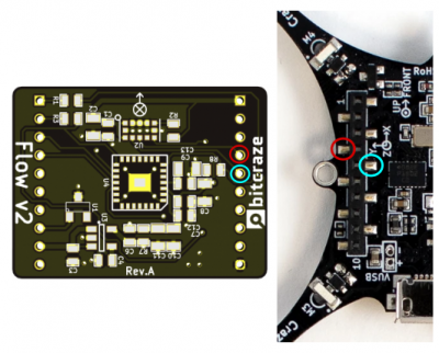

Do you have a multimeter so you could check that you have a connection between the CF2.1 and the flow deck? Especially check the i2c bus (pin 4,5 on the left side). To rule out soldering issue of the connector try to measure on the soldering pad. If you feel uncertain how to do this I can try to put together an explaining image.

Re: flow deck v2 error
Check that it is a connection between the two red measurement points and between the two blue when they are mounted together.

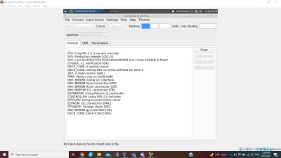

I changed the pins to see if the flow deck worked and it did for a while. Then it had the error again. You are probably right and there is a soldering problem.

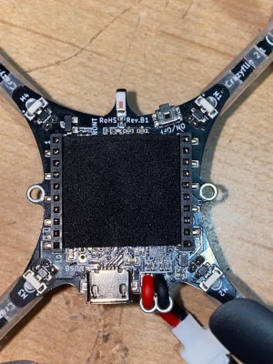

I think the soldering is good but I attatched an image in case you see something wrong.

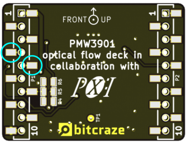

It is hard to see in the image and it can be very subtle but often noticeable if one looks closely. Also the foam pad is in the way to see the inner legs. I highlighted the pads on the flow deck that are most likely to have a problem but it could be one of the others. If you feel uncertain perhaps you can take a close up high resolution image and possibly I could spot it.
After testing a bit myself I think it is most likely pin 1 (VCC) on the left side that is not connected.

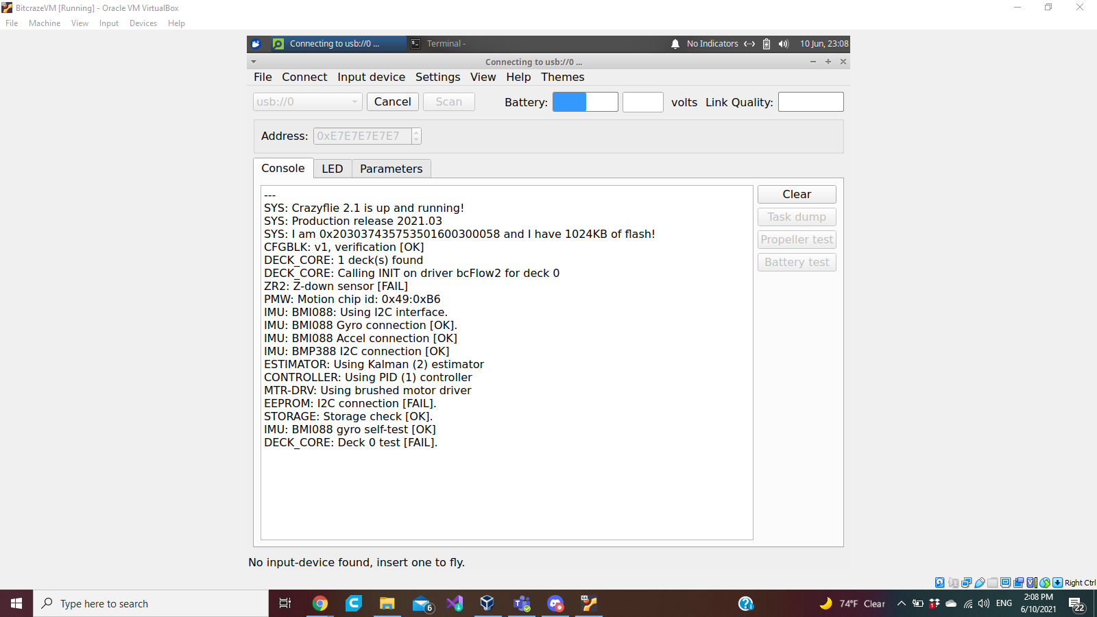

So my research professor had to give me a new Crazyflie since the flow v2 deck was new and it is rare that it is failing. When I connected it to the new Crazyflie the flow v2 and multi-ranger worked perfectly. So, I guess it is a Crazyflie error.
Then we know it is the Crazyflie. I'm pretty certain now that it is pin 1 (VCC) on the left side that has a glitch. Feel free to contact us at support@bitcraze.io to ask for a replacement board.
