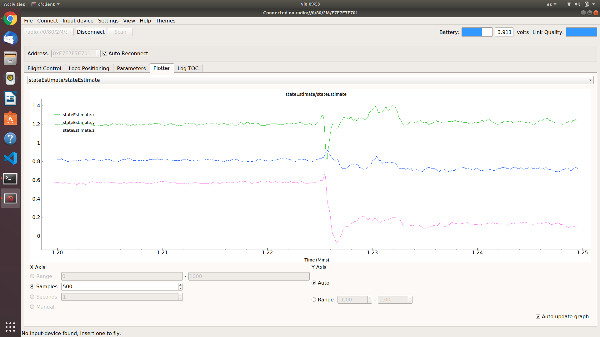

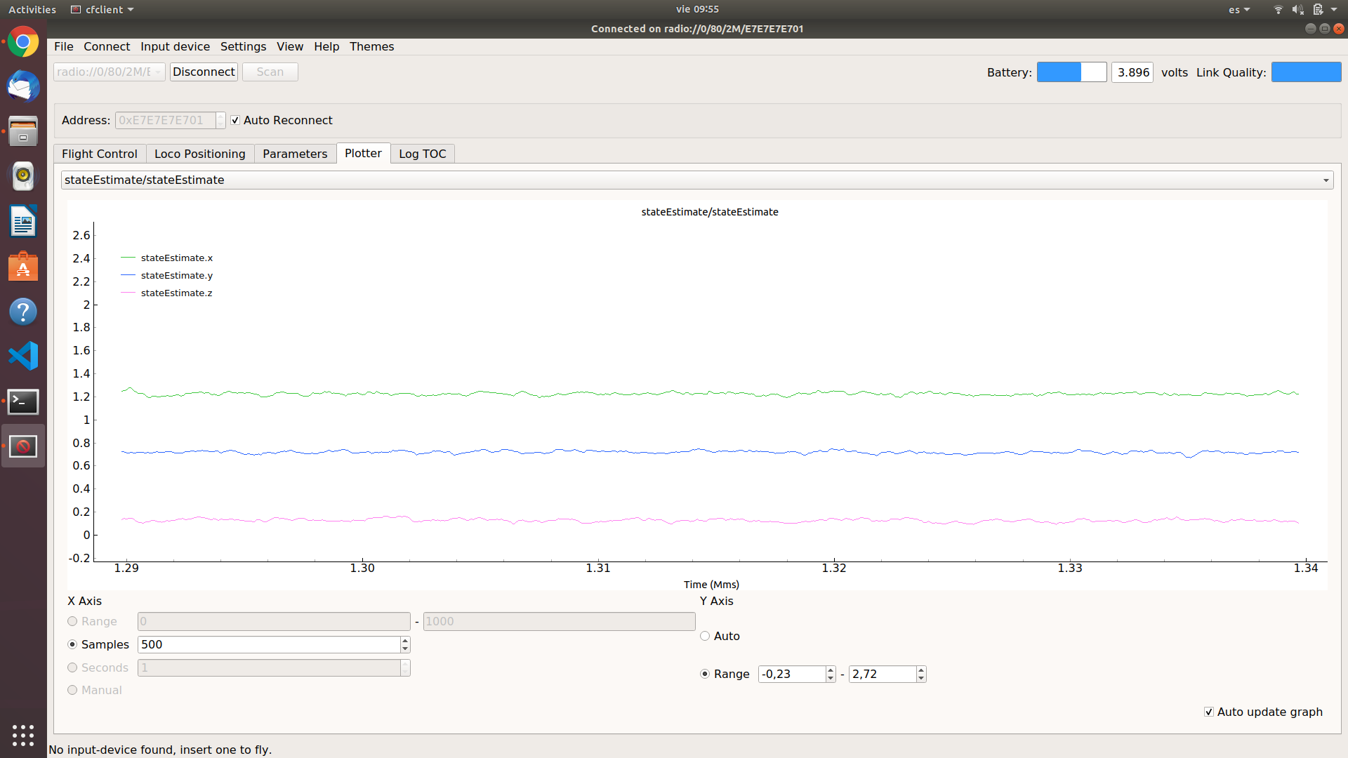

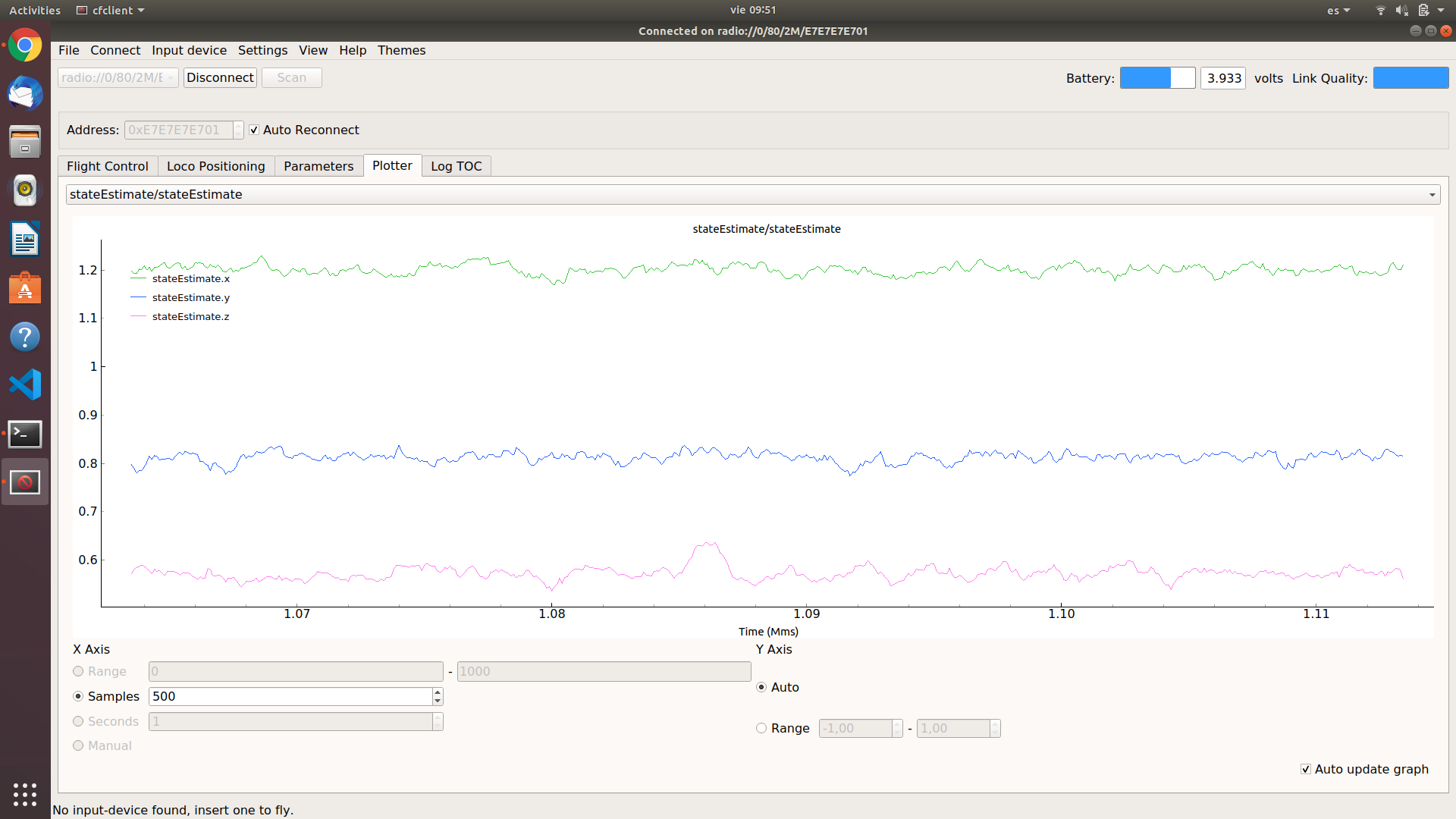

Hi again,
Here is the graph of the CF on top of a chair, the real height is around 0.6 meters, which is ok, the second graph is when I moved the CF to the ground, and the last one with the CF on ground after a few seconds.
