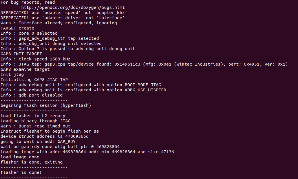

Yes, I also checked the USB port. After connecting according to the manual, I also ran the flash command.
However, it ends at that part as shown in the picture attached above. Do you know why?

The screenshot you showed, showed the programming sequence for the Nina module. This what you are supposed to see when it succeeded actually. I see the same thing. Just be sure that you are flashing the Nina module and not the Gap8.
There is no order in which you have to flash the Nina or Gap8. I usually flash the Nina first and than the GAP8, but its up to you.
Also once you have flashed the Nina to your liking (either as accesspoint or it connecting to a wifihotspot), you would not need to flash it again and keep it exactly as is.

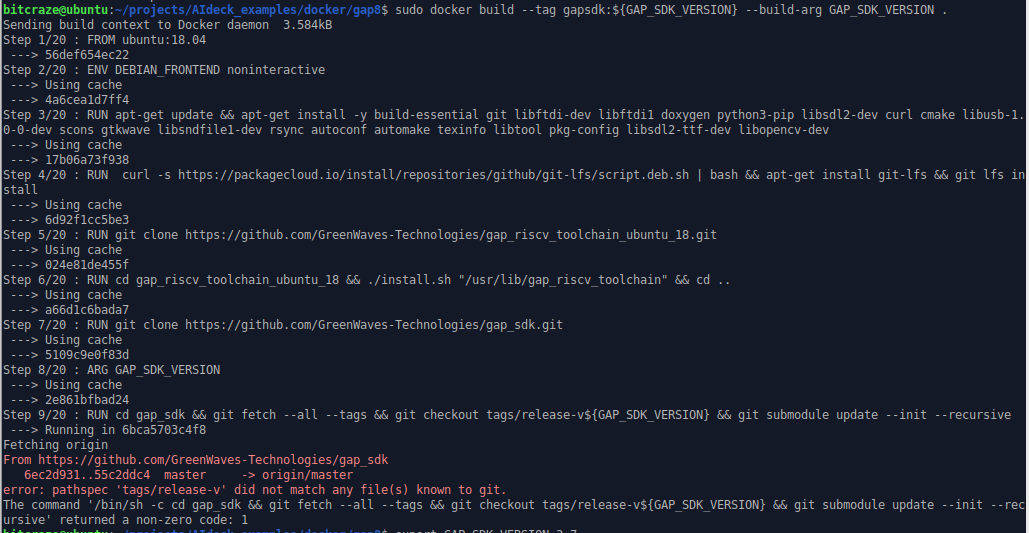

I'm also going to start gap8 using docker.
But I get an error as shown in the picture.

please follow the docker build instructions. You need to specify the sdk version first.

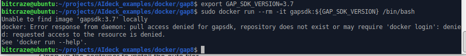

export GAP_SDK_VERSION=3.7
Is this code correct?
If yes, I have already specified it.
Posts: 1050
Re: Wifi video streamer
Post by kimberly »
It needs to be done in the same terminal as you do the build. Currently it is trying to grab the tag release-v while it should grab the release-v3.7 tag.
Maybe it would be good to add it to bashrc, like indicated in the instructions.
