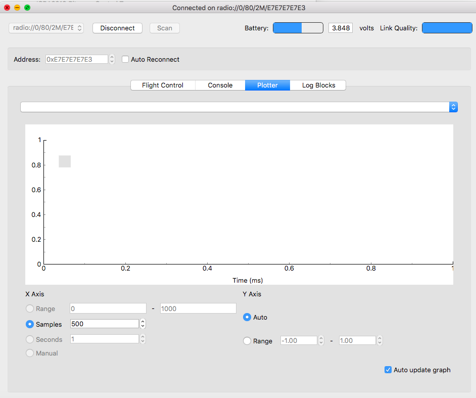

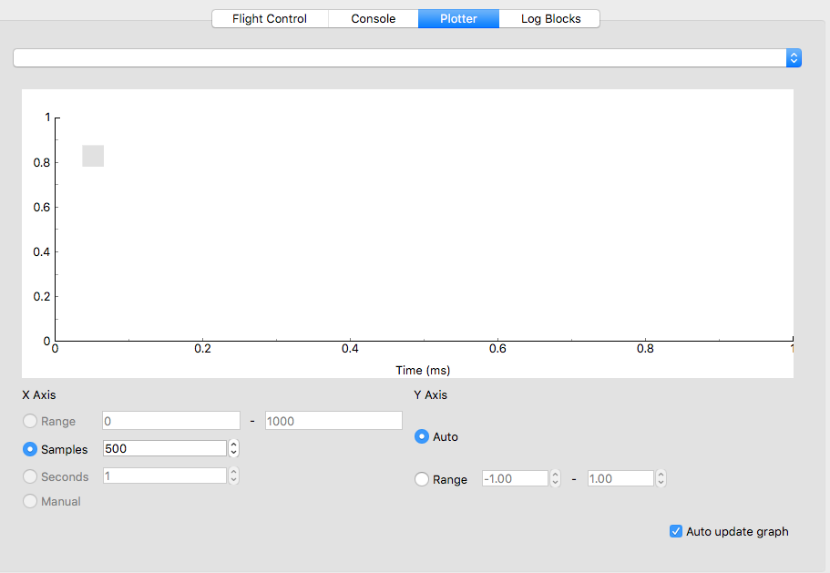

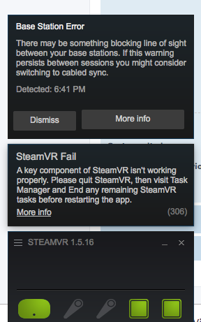

There are several error I found from my macbook environment
I am not sure if I would be the cause of problem or not.
1. VR pop out of error message randomly. Some time not
2. I can't plot the graph even I can connect to the cfclient properly.

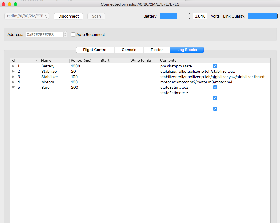

- Posts: 2538
Re: Control Tower Error
1. The message you get from steamVR is caused by the lighthouse base station not seeing each-other reliably. You should make sure your base station have good line of sight to each-other or use the sync cable and set the base station in mode A and B. Any other failure should not matter for Crazyflie, and you do not need to keep steamVR running to fly Crazyflie.
2. You need to add a log block as documented there: https://wiki.bitcraze.io/doc:crazyflie: ... ex#logging. Once you have added the log block with the variables stateEstimate.x/y/z. Once the log block is created, it will appead in the list of log blocks and in the plotter list: https://wiki.bitcraze.io/doc:crazyflie: ... ex#plotter.
